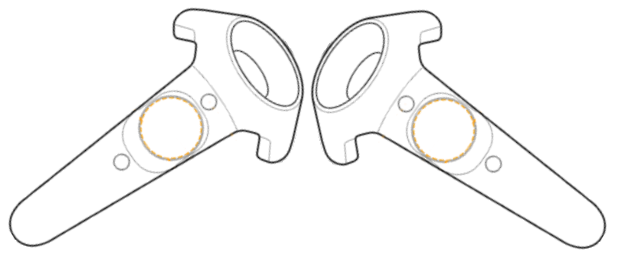

How to Switch Between Hands and Controllers
There are two ways to switch between displaying hands and controllers. With both, to return to the other state, repeat the action.
Click the Controller/Hand button from the VR Menu.
Align the top of the controllers, bringing them together.
When using the controllers, tooltips appear to show which functions are controlled by which control.

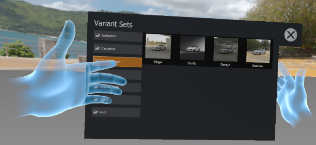

How to Access Variant Sets
If variant sets (VSets) are set up for a scene, they are accessible through the Variant Sets option in the VR Menu.
Use the VR Menu on your controller to access the VR Menu home page.
Click Variant Sets to open the Variant Sets panel.
Click a variant set to change something in the scene.

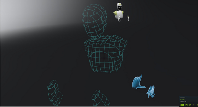

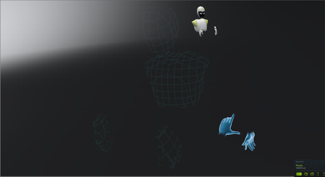

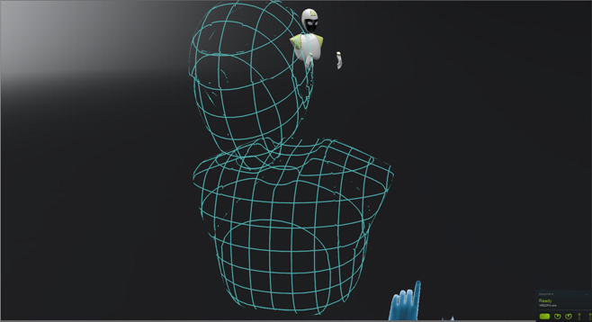

How the Safety Twin Works
When multiple participants are in the same real-world space, without some type of safety mechanism in place, collisions can occur. In VRED, we added the safety twin to provide a visual cue to keep you safe and help avoid collisions.
When a blue grid mesh appears (the safety twin), that indicated another participant is nearby.
As they move closer, the mesh of the safety twin begins to fade, becoming increasingly transparent.
If the safety twin becomes completely transparent, that participant is dangerously close.
