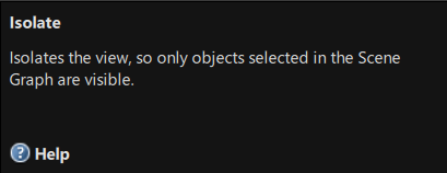

Tooltips
Hover over a tool or option and wait a moment to display a tooltip.
Help Link
Within many of the tooltips is a Help link. Click this to open a help topic.

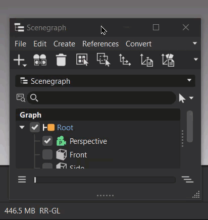

Status Bar
Below the viewport and QuickActions Bar, you will find the status bar. It indicates memory usage, the visualization mode, and which part of the interface is active. For more information, see the Status Bar.

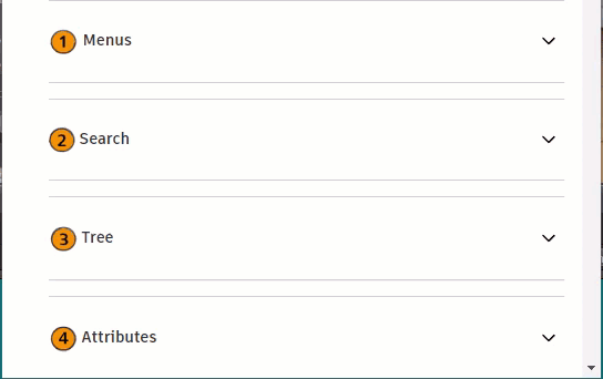

The VRED Menus button along the top provides a list of menus corresponding to the main VRED menus. Click an option to open a landing page with links to help for each menu option.

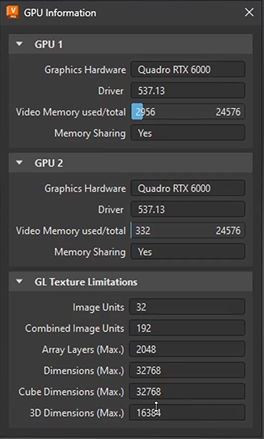

GPU Information
The GPU Information dialog provides GPU stats for each graphics card used, such as the kind of graphics card, driver, minimum and maximum video memory used, and whether memory is shared. For OpenGL, it provides the image units, combined image units, as well as the maximum texture limits for array layers and dimensions. Find it under Help > GPU Information. When displayed you can still interact with VRED.
Use the hotkey Ctrl + C to copy the currently selected GL extension string to the clipboard.

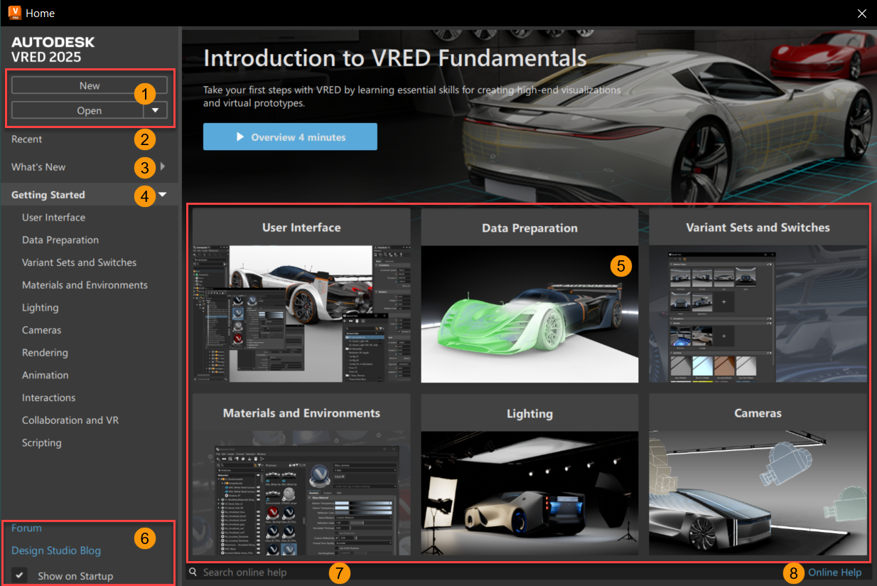

The Home dialog is the first thing that appears when you open VRED and contains an assortment of useful links for new and returning users. A list of recently opened files are displayed, by default, that you can quickly access and copy file locations. Once a file is selected, the Home dialog automatically closes. Click the other buttons, links, and tabs to the left to access additional content.
New and Open Buttons
These are the buttons found in the Home dialog:
New - Closes the Home dialog and creates a new scene in VRED.
Open - Provides two options.
Open to open a chosen scene in VRED and automatically close the Home dialog.
Open Examples to open the VRED example folder containing sample projects showing how to set up simple constraints, Python scripts, tracking, touch sensors, VR hands, and more. Double-click a file to open it in VRED, automatically close the Home dialog, and begin working.
Note:When using Open or Open Example, if you cancel the Open File dialog, the Home dialog reopens.

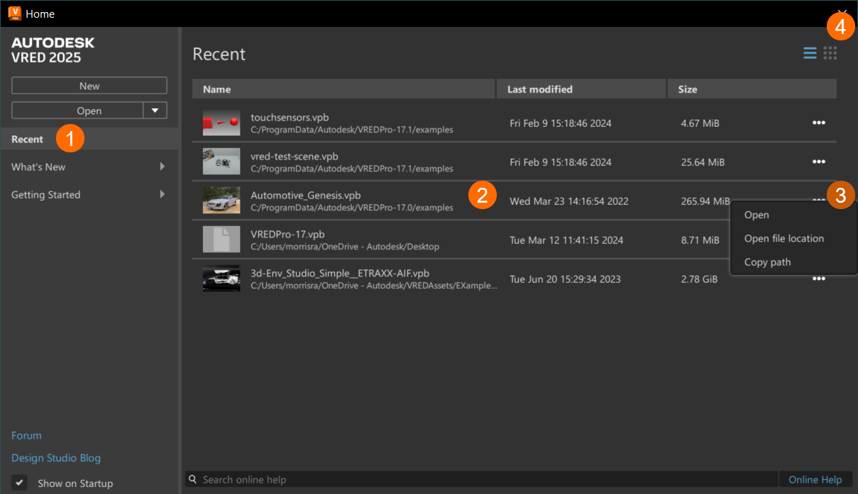

Recent
Use the Recent tab to easily access the most recent 30 projects and quickly see a file's name, location, and size. By default, the last modified is the first listed.
Click Recent to display a list of your most recent files.
Recent Tab - Click to display a list of your most recent files. Double-click a file to load and open it as is.
File Information - Provides the file name and file path, last modified, and file size.
Options - Click ...to access the following options:- Open - Opens the selected file in VRED. To open a file, either double-click or click
...and select Open. - Open File Location - Opens the folder where the file is stored. To open the folder where a file is located, click
...and select Open File Location - Copy Path - Copies the path of the file to your clipboard. To copy the file path, click
...and select Copy Path.

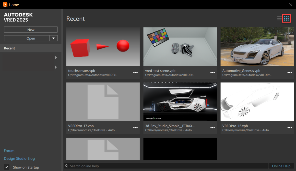

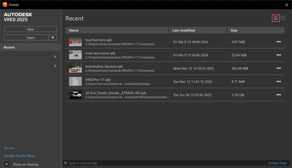

List and Thumbnail - Changes the display of the recent files. Choose from the following:
- Click to display the recent files as a list.
- Click to display the recent files as thumbnails.
What's New
The What's New section contains videos, which are updated with each release.
- Click the What's New title to expose the latest topics and display their cards.
- Click any listed topic or card to access video content.
- Within each topic is a Learn More button, which delivers additional video and tutorial resources, along with links for changing language settings.
Getting Started
The Getting Started section contains User Interface, Data Preparation, Variant Sets and Switches, Materials and Environments, Lighting, Cameras, Rendering, Animation, Interactions, Collaboration and VR, and Scripting videos tutorials.
- Click the Getting Started title to expose a list of topics and display their cards.
- Click any listed topic or card to access the content.
