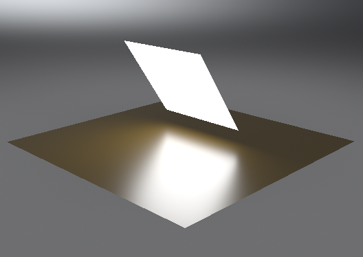

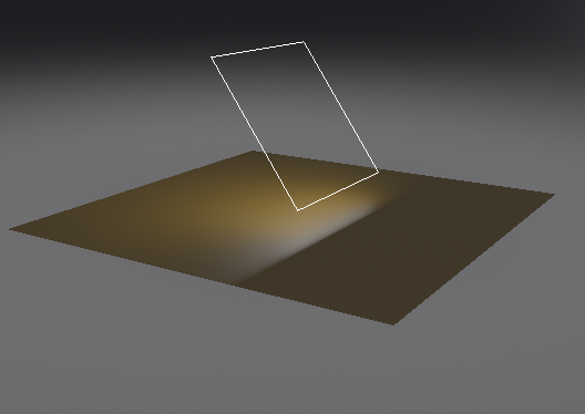

Area lights before VRED 2025 were two-sided, meaning one side was illuminated (A-side), while the other was opaque (B-side).
| 2024 A-side | 2024 B-side |
In VRED 2025, we made the non-illuminated side transparent and added a wireframe outline. Now, when a camera is facing this side, the light can be found.
| 2025 A-side | 2025 B-side Wireframe |

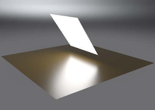

Since area lights now have a wireframe visualization, you may choose to hide this. Use Show Light, previously called Display Light, found in the Light Editor > Light Settings > Visualization section, to display or hide the wireframe.
| Show Light Enabled | Show Light Disabled |

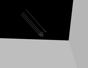

Directional Light
Light rays from directional light sources are parallel like sunlight. A directional light represents a distant light source and has no position, only a direction that affects how the scene is illuminated.

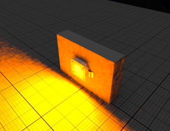

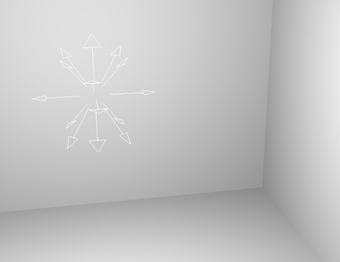

Point Light
Point light rays start at a single point and emit radially.

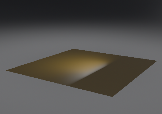

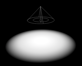

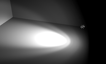

Spot Light
Spot light rays follow a beam cone. They start at a single point and spot in a circular area on the object. It is often used to emphasize an object or surface.

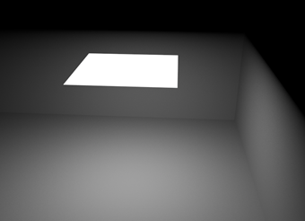

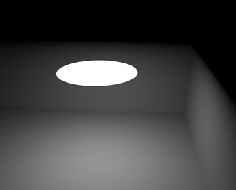

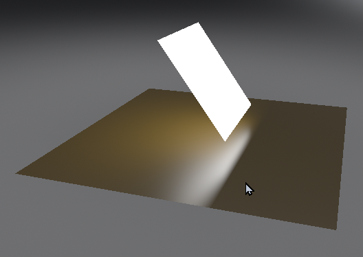

Disk Light or Rectangular Light
The disk and rectangular lights are area lights that emit light from a flat surface, either from a circle (disk) or square (rectangular).
| Disk Light | Rectangular Light |
Use these to creating area lights to connect to HDR Light Studio. See How to Connect Area Lights to HDRLS.
In Render Settings > Raytracing Quality > Illumination Mode, enable Precomputed + Shadow, Precomputed + IBL, or Full Global Illumination for the correct diffuse, glossy, and specular reflections, as well as shadows from area lights. Also, pay attention to the area light's actual 3D position inside the scene. If the area light is outside the dome (environment geometry), it won't be seen inside the dome or in the specular reflections. To correct this, place the area light within the dome and enlarge the dome. By default, the dome has a radius of 10,000 mm (10 meters).

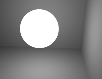

Spherical Light
The spherical light is an area light that emits light from a sphere. It is more realistic than point light.
