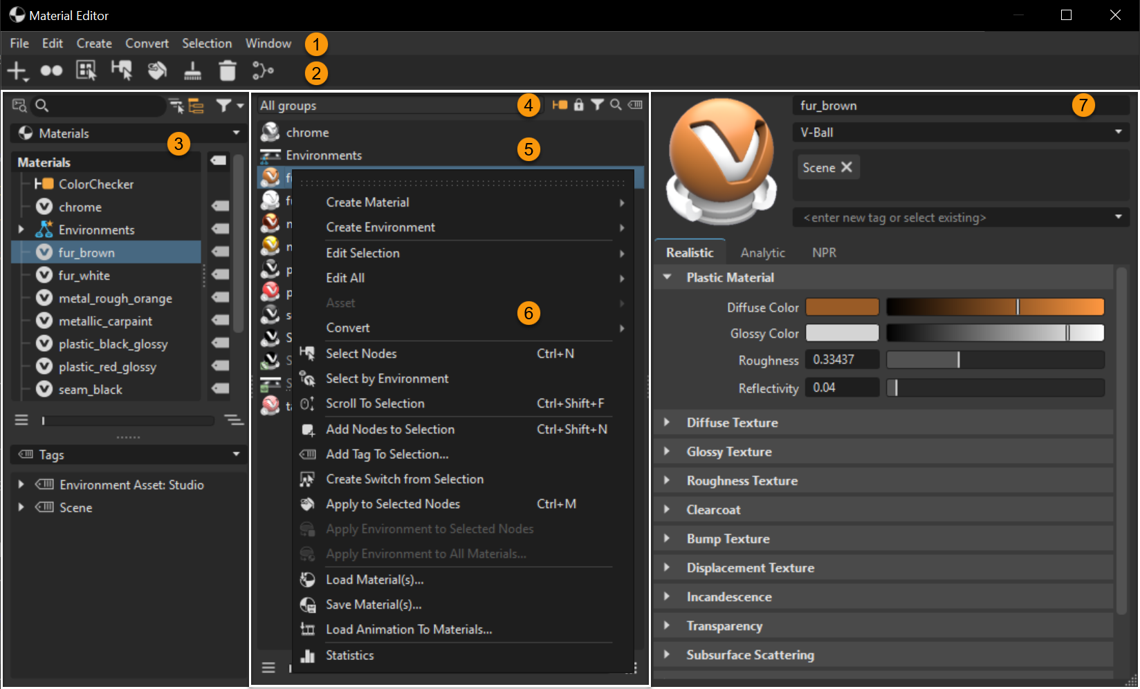

Use the Material Editor to create, modify, filter and search, and group materials within VRED. Use the drag and drop operations and preview feature on material assignment to saves time on scene setup. For information on specific materials and their attributes, see the Truelight Materials Reference section.
Material Editor
Click the links below for more information:
1 Menu Bar
2 QuickActions Bar
3 Material Graph/Tags
4 Advanced Search, Search, and Filter
5 Group Preview
6 Context Menu
7 Attributes
