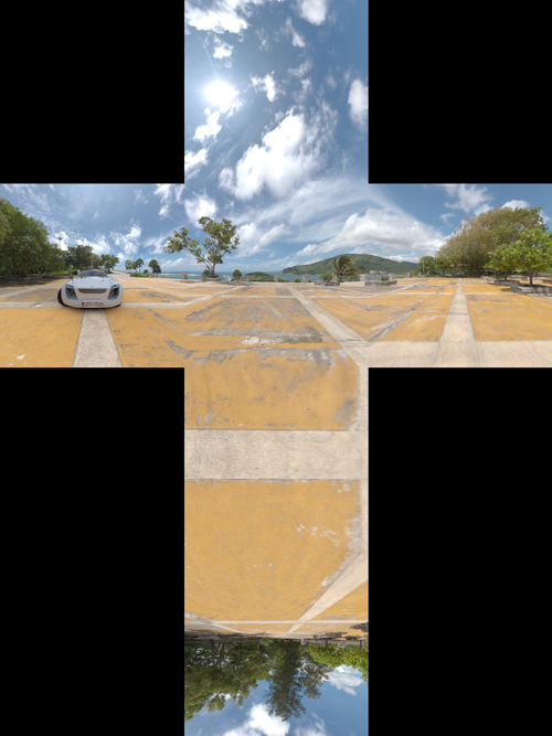

    • Vertical Cross
      Vertical Cross rendering

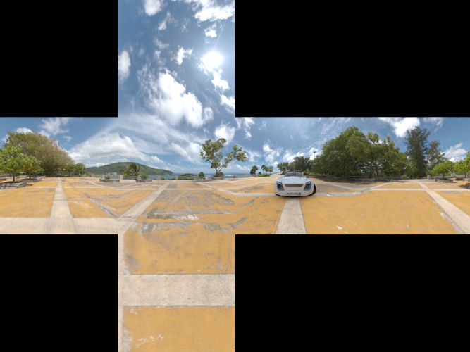

    • Horizontal Cross

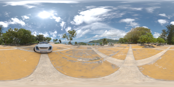

    • Spherical Map
      Spherical Map rendering
