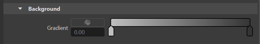

Background
Sets the background colors of the viewport. The background can be a gradient, with different colors set at specified positions. Use the sliders to define the colors used to create the background gradient or click a slider, then use Color Picker or click a slider and enter a numeric value in the Gradient field. Define each color using RGB values and with positions ranging from 0 to 1 (bottom to top).
background colors UI
