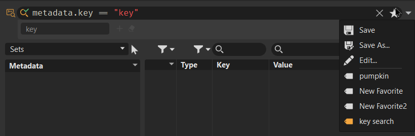

  • Menu Structure - Select the default behavior of the Favorites menu structure. Choose from Grouped and Flat.
    • Grouped - Displays all favorites in the Favorites menu grouped in a folder.
      Grouped Favorites menu entries

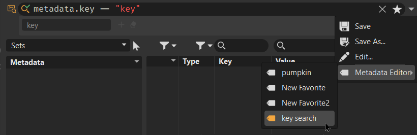

    • Flat - Displays all favorites in the Favorites menu as a list.
      Flat Favorites menu entries
