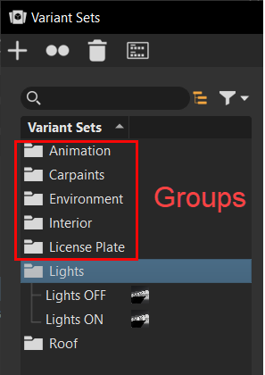

When you want to render out numerous configurations of variant sets, save time and use variant set batch rendering. This enables you to quickly and easily set combinations of colors, environments, geometry, and more, as long as your variants are grouped into folders in the Variant Sets module.
Variant Set groups

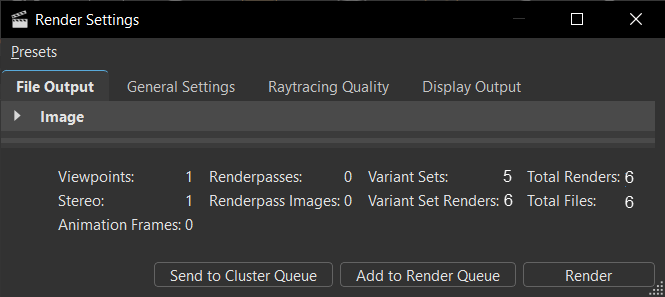

Use the readout at the bottom of the Render Settings module for the number of files rendered and a breakdown for each component. For example, if 3 carpaints and 2 environments are selected, 6 renders and files are generated.
Render Settings readout for rendered data

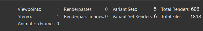

However, when you add 100 stop frames of animation and 3 different renderpasses, the number jumps to 606 renders and 1818 files.
Animation and renderpasses added

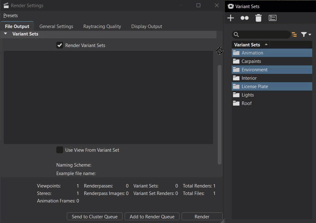

  1. In the Render Settings > File Output > Variant Sets section, enable Render Variant Sets.

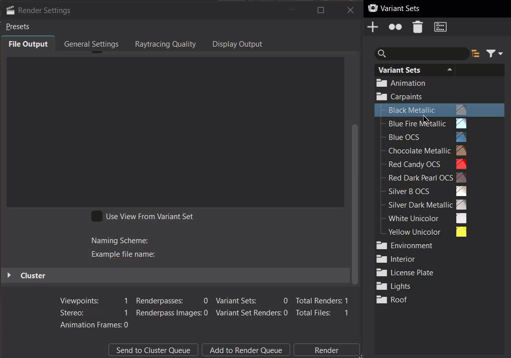

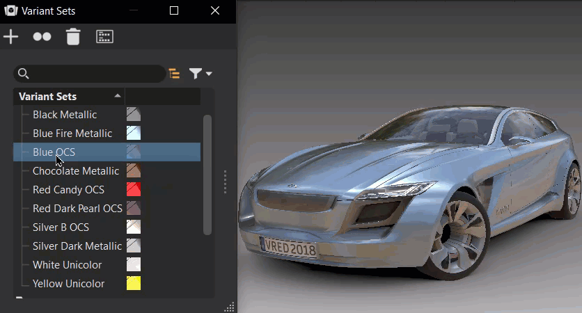

  2. In the Variant Sets module, do any of the following to add variant sets to the Variant Sets section:
    • Click-drag or Shift-drag folders, then check the needed variant once listed in Variant Sets. To enable all variants in a variant set, click its folder.
      Add folders
    • Ctrl-click to select all needed variants, then drag them. These variants will automatically be checked.
      Auto-enabled added variants
    Tip:
    Double-click variants in the list to trigger and see how they look without returning to the Variant Sets module.
    Double-click variant changing

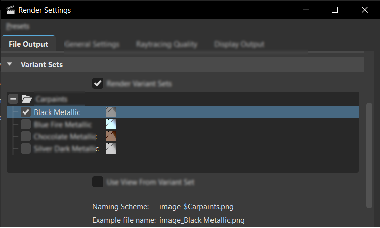

  3. In the Render Settings Images section, use Filename to set where the images will be saved and the filename used.
    Tip:
    To see the naming convention used for the generated images, look below the variant sets list. Naming Scheme shows how the name is created. Example file name shows an actual example name. To change the order of the strings in the filename, click-drag folders in the Variant Sets section above or below another.
    Used naming conventions
