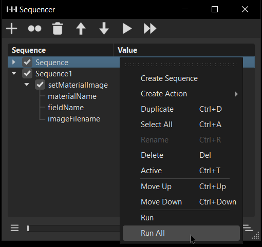

  1. Select Interaction > Sequencer.
  2. Right-click inside the Sequencer module and select Create Sequence.
  3. Right-click the new sequence, select Create Action, then the action you want from the context menu.
  4. Repeat step 3 to add other actions to the sequence.

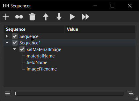

How to Disable an Action Inside a Sequence
To disable an action inside a sequence, deselect the check box beside the action.
Sequencer
How to Use the QuickActions Bar Controls
  2. Use the controls in the QuickActions Bar to delete, duplicate, or change the order of sequences.
How to Run Command Sequences
To run one sequence, including all its enabled actions:
  1. In the Sequencer module, right-click the sequence you want to run.
  2. Select Run.
    Sequence Run All
To run multiple sequences:
  1. In the Sequencer module, select the check boxes beside the sequences you want to run.
  2. Right-click inside the module and select Run All.
