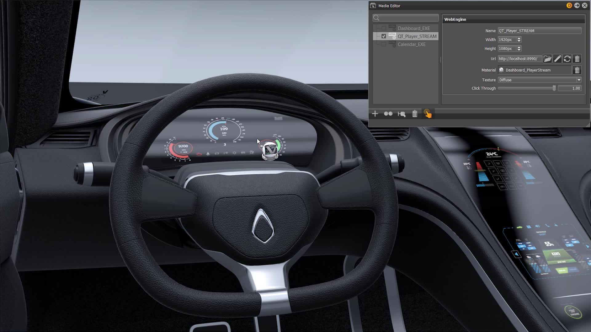

QtQuickStreaming Video Captions: Stream QT content directly into the VRED scene, using a newly built script module. Just go to Scripts > QtQuickStreaming. Here you can start a stream, using an .exe file that contains QT content. Now, you must create a web engine that can be linked to the stream, like here in the dashboard example. Within the QtQuickStreaming window, you can add multiple streams and assign them to other parts of your scene, using the Media Editor. Here you can see the QT dashboard content and the QT calendar running at the same time. Your configuration of multiple streams can then be saved by selecting File > Save in the QtQuickStreaming window and stored under the Scripts menu and be loaded from there again, using File > Load in the QtQuickStreaming window.
Another way is to directly start a webstream out of QT Design Studio, for example. Therefore, you have to create a new run configuration within QT Design Studio, using the command that tells the software to stream to a specific port. In this case, I am using the port 8990. This stream is just running in the background and can be used within VRED by using the right URL and port number directly in the Media Editor's web engine, like you can see here. With the new script, you are able to run all your QT content in VRED and save and load configurations, which saves much time in the design process.

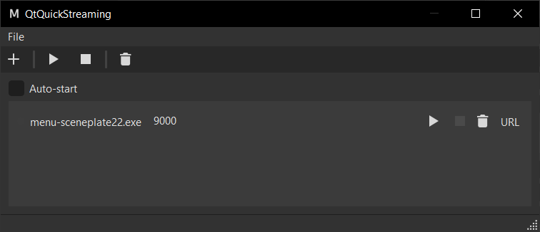

About the QtQuickStreaming Dialog
QuickActions Bar
Use the tools in the Icons Bar for the following:
  • Add an executable Add - Adds a Qt application executable to the list. See step 2 of Playing Streamed Qt Content.
  • Start all processes Start all processes - Starts steaming all processes in the QtQuickStreaming dialog.
  • Stop all processes Stops all processes - Stops steaming all processes in the QtQuickStreaming dialog.
    When VRED terminates, all processes are stopped automatically. Only in cases where VRED crashes without a crash report, will the started processes continue to run. Look for these process in the Task Manager.
  • Delete all processes Deletes all processes - Deletes all processes in the QtQuickStreaming dialog.
Application List
This section of the QtQuickStreaming dialog lists the Qt Quick application executable names, along with the ports used for WebGL streaming. The port number can be changes only when the process is not running (i.e., before it has been started).
These buttons are found next to every executable:
  • Start the process Start - Starts a Qt process.
  • Stop the process Stop - Stop a Qt process.
  • Delete the process Delete - Stops and deletes a Qt process.
  • URL - Copies the web URL of the streaming web server to the clipboard. Use this URL for a WebEngine. See step 4 in Playing Streamed Qt Content.
    For example, create a WebEngine in Media Editor or a frontplate with type Web in the Sceneplate Editor. Paste the copied URL (it should look like: http://localhost:9000 for port 9000) to the WebEngine and press Enter. If successful, you will see the Qt Quick application rendering in VRED on the frontplate or the geometry using the WebEngine.

  3. Create a WebEngine.
    1. Select Scene > Media Editor and click + (WebEngine).
    2. Set the width and height for the resolution.
  4. Set the URL for streaming.
    1. In the QtQuickStreaming dialog, click the URL button to copy the port to the clipboard.
    2. In the Media Editor, right-click the URL field and select Paste to add the port URL to the WebEngine.
