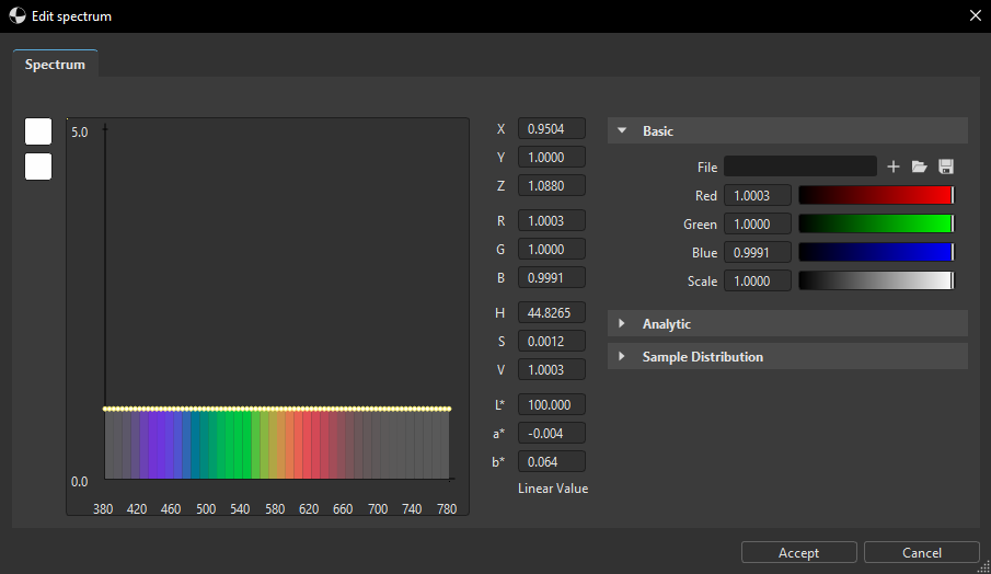

      • Spectral Distribution - Uses the refraction indices defined by the spectrum. This affects the radiating light dispersion. For example, tinted UV glass would have a different spectral distribution than a headlight. When enabled, an IOR Spectrum option appears. Click its Edit button to edit the spectral distribution. Click Accept when finished to save changes.
        Spectral Distribution dialog
        Note:
        Abbe Number is disabled when Spectral Distribution is enabled.
