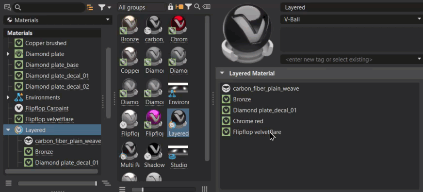

Layered Materials in the Properties Editor

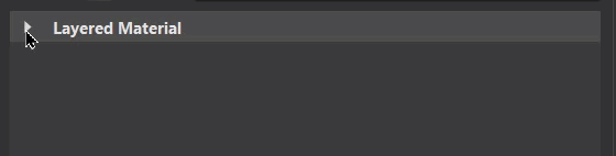

When a layered material is selected, its material variants are listed in the Properties Editor. However, if they aren't, click the section title.

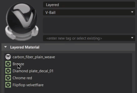

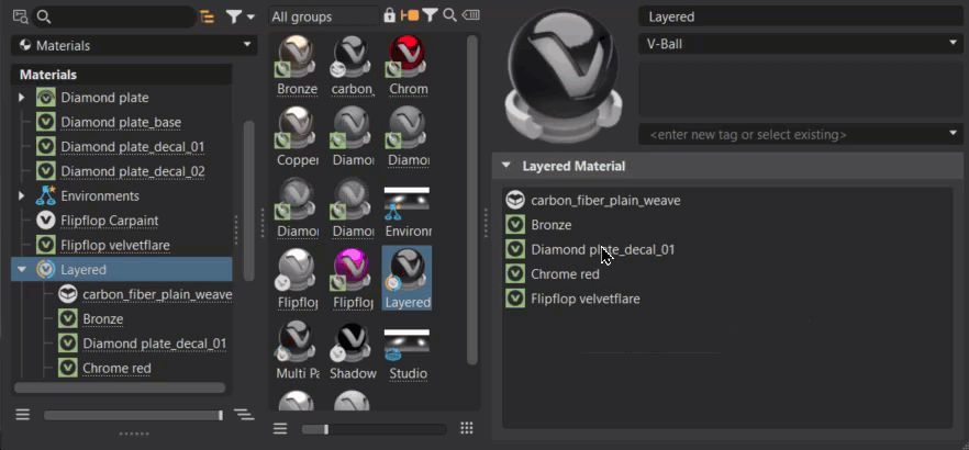

Select a material variant from the Layered Material list and right-click to access the following options:
Select Material (Ctrl+N) - Use for loading the properties of the layered material's original material into the Properties Editor. With a layered material selected, right-click one of its material variants and select Select Material to load the original material properties, not those of the material variants
Select Child - Use for loading the properties of a layered material child into the Properties Editor. With a layered material selected, right-click one of its material variants and select Select Child to load its properties, instead of those of the parent material.
Notice the change above the tabs. Clicking the parent tab returns to the list of material variants.
Paste (Ctrl+V) - Adds the copied material to the layered material.
Delete (Del) - Deleted the selected material variants from the layered material.
Move Up (Ctrl+PgUp) - Moves the selected material variants up in order, switching it with the one previously before it.
Move Down (Ctrl+PgDown) - Moves the selected material variants down in order, switching it with the one previously after it.
