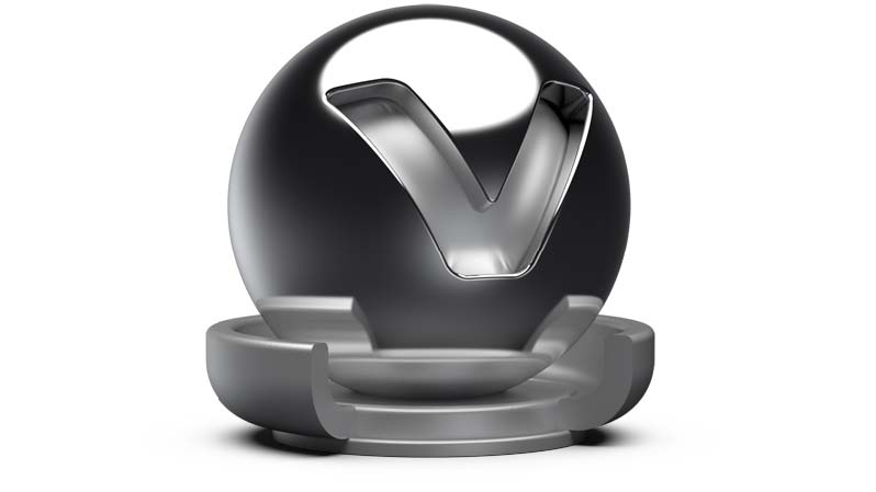

Line Chrome
The Line Chrome Material is a special variant of the chrome materials for line geometries. This material does not work on triangle-based or NURBS geometry.
Reflection Color - Sets the color of the specular reflection, based on the color of the light source(s).
Roughness - Sets the glossiness of a material, without affecting the specularity. The lower the value, the glossier the material.
Line Width - Sets the width of the line geometry.
