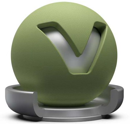

VRED supports the use of measured materials. Measured materials contain internal surface reflection information that considers reflection behavior from different viewing angles, ensuring photo-realistic illustration within the render view. Create this through the X-Rite Measured material.
