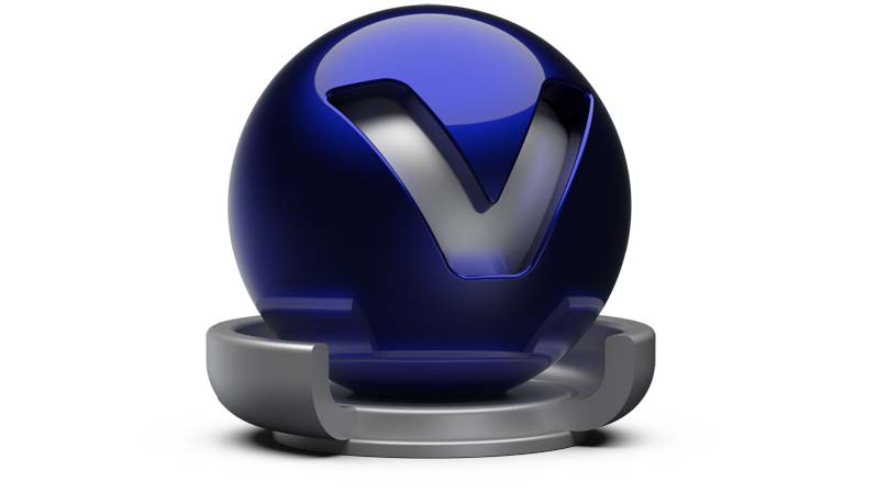

A metallic car paint material has small particles made of metal, or flakes, on top of its lacquer layer. These particles increase the brightness within the angle of incidence, causing a light textured look. The color and size of the flakes is customizable.
The basic structure of this kind of paint consists of a mix of three or four different layers.
  • The base layer is a solid diffuse colored layer at the bottom to give a constant colored basis, independent from the actual material it is applied to. Usually, grey is used for this layer.
  • The second layer is the Primary Flake Layer. It contains both colored diffuse pigment particles that give the basic color impression and randomly distributed flakes.
  • The third layer is the Secondary Flake Layer. Its attributes are identical to the attributes of the Primary Flake Layer.
  • The last layer is the Clearcoat Layer, which is a specular layer. It can also have colored pigments in it.
