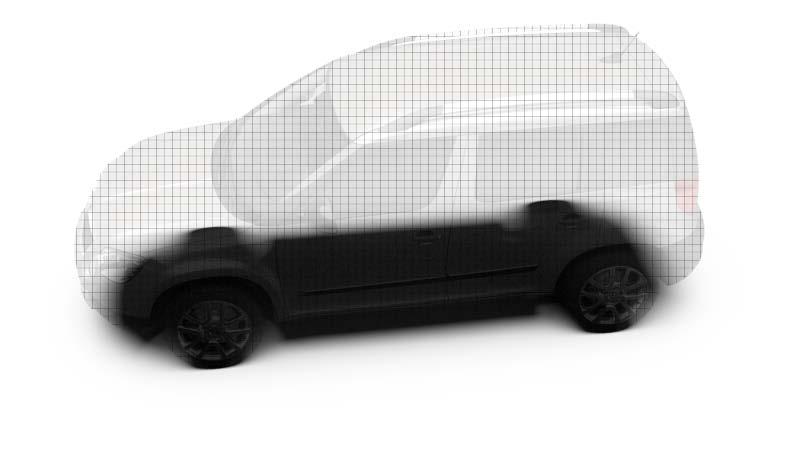

The Shadow material is a transparent material by default. It is shaded only in areas of pre-calculated ambient occlusion shadows, shadows calculated by linear lights sources, or global illumination light sources. It is also capable of receiving diffuse and glossy reflections to simulate wet or mirroring surfaces.
Video captions: Create a shadow material and allocate it to a geometry. A shadow material predominantly absorbs shadows. In the shadow material, the Occlusion Color and Shadow Color are being distinguished. By modifying the occlusion color, HDR shadows will be highlighted in different colors. With the help of Shadow Color, all shadows can be dyed with direct light sources. The Opacity Mode can define whether the shadows should be drawn transparent or solid.
