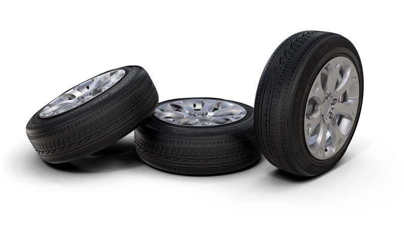

Tire material supports several surfaces and structures for rim and profile within a single texture. Rubber shading rounds off whole thing. The tire material texture settings allow the accurate placement and wrapping of textures to fit a tire shaped object.

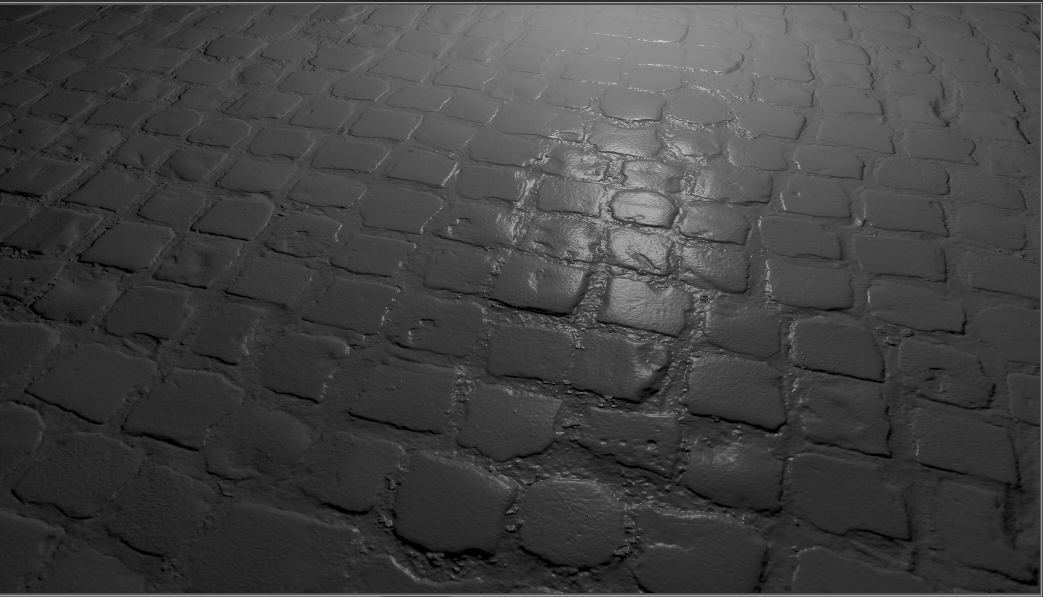

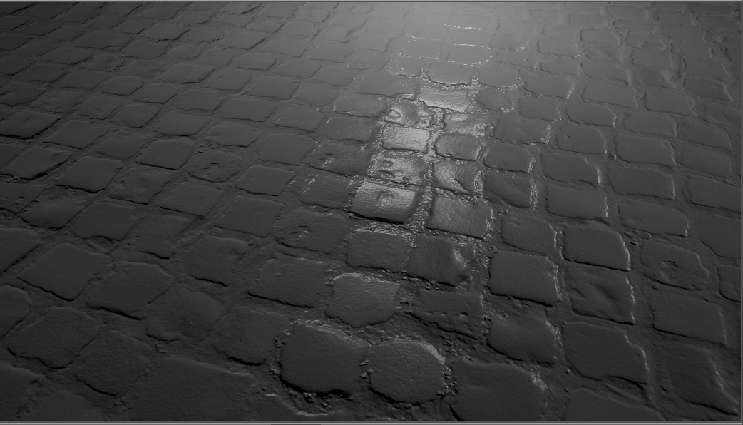

  • Flip U and Flip V - Switches the orientation of the U and V tangent directions stored in the normal or bump map of the markings texture. The profile texture should always be a height map and therefore flipping should not be required.
    To fix the normal map's tangent vectors orientation, change one of these and see if it corrects the issue. If it doesn't, disable that option and enable the other, or Enable both Flip U and Flip V. These options enable VRED to support different kinds of normal maps, as they provide a solution for aligning the normals.
    Flip U Disabled Flip U Enabled
    Incorrect with Flip U disabled Corrected with Flip U enabled
    Note:
    When using Flip U or Flip V for a normal map, the Parallax Intensity value should be kept at 0.0, as the height cannot be estimated in this case.
