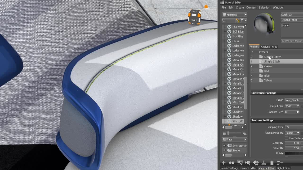

Material Filtering and Representations Video Captions: In this video, you will see more news and features of the reworked Material Editor of VRED 2023. If you want to load, for example, multiple materials, such as X-Rite or Substance materials or multiple environments, you can now select multiple files at the same time within your windows browser and do a bulk load. After loading a bunch of Substance materials, I want to filter for them. And, I can do that now using the new filter toggle, which I can turn on or off, which is very helpful if I need to use the same filter multiple times. And also the preview window can no follow the filter toggle, so that I can easily toggle between all materials and only my Substance materials, for example.
Specifically for the Substance materials, we added a new option. In Adobe Substance Designer it is possible to capture only specific values in Presets. And in the VRED Preferences, it is now possible to decide what happens with these un-captured values, so you can select between Apply & Reset and Apply & Merge. This gives you the possibility to combine different presets, like I can do here, where I can select a double or single stitch and also select different colors presets. When now assigning a material, you can use the drag and drop functionality.
Here’s a quick tip, in case you didn’t know. You can drag and drop a material with the middle mouse button to replace a material or use the right mouse button to add a decal to a multi pass material, for example, or create a switch.
If you are dealing with textures, you might also sometimes run into a texture tiling issue. Like here, where I can see the tiling of the floor material. This can be very tricky to resolve, but now we have a new option, called Use Infinite Tiling. Just simply enable it and adjust some settings if needed, and the tiling is gone. This can save you massive time and increases faster your visual quality.
Additionally, we added 11 different shader geometries. Now you can set every single material to a more appropriate geometry. This also helps to identify materials better in the preview window, as you can set a fabric to a cloth geometry, for example, which is very helpful for getting a faster overview.
It is also possible to add custom shapes by modifying the MaterialBall VRED file, that can be found here. I did for example a custom tire rim and plastic part and added it into the file. And with the new multi selection option, you can also set multiple materials to a different shader geometry in one go. Thanks for watching the video.
