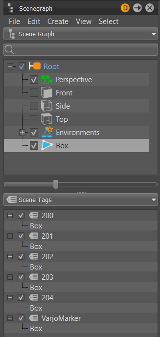

Preparing Nodes for Markers
Only available for Varjo XR HMD users.
Follow these steps to prepare your nodes before entering MR. Note that objects that won't fit in your room will need to be scaled down before entering MR.
Example scene tag node structure for markers
  1. Add a tag and rename it VarjoMarker.
  2. Drag and drop an object node onto this tag to assign it.
  3. Create another tag and rename it to the number printed on the Varjo marker.
    Marker in a scene with close up of number
  4. Drag and drop the same object node onto this tag.
