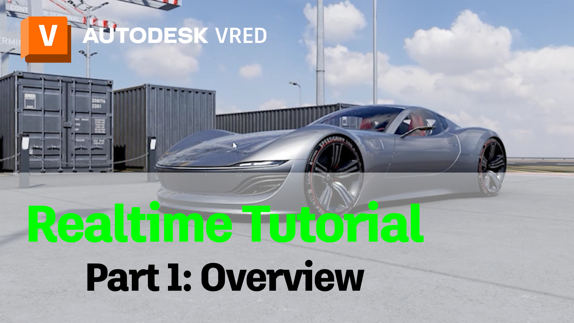

Part 1: Introduction to Real Time and VR
This first part of the series is where you learn more about real time scenes with VRED.

With OpenGL, there are two major points to note compared to traditional offline rendering: First, the shadows or light are precalculated, and second, the reflections of the environment are currently multiplied into the materials. For this reason, self-reflections within the vehicle, like here at the side mirror, are not rendered. The reflections of the environment are, therefore, visually plausible, but not physically accurate – however, more on that later. The biggest advantage of this rendering mode is the extremely good performance, even with very large data sets and millions of polygons. Using this harbor scene as an example, we can see that even around 65 million polygons can still be rendered with a very good frame rate, depending on the graphics card used. This render mode is also the default render mode, and can be activated with the shortcut, F3. For comparison, you can activate raytracing with the shortcut, F4, and see physically correct reflections.
