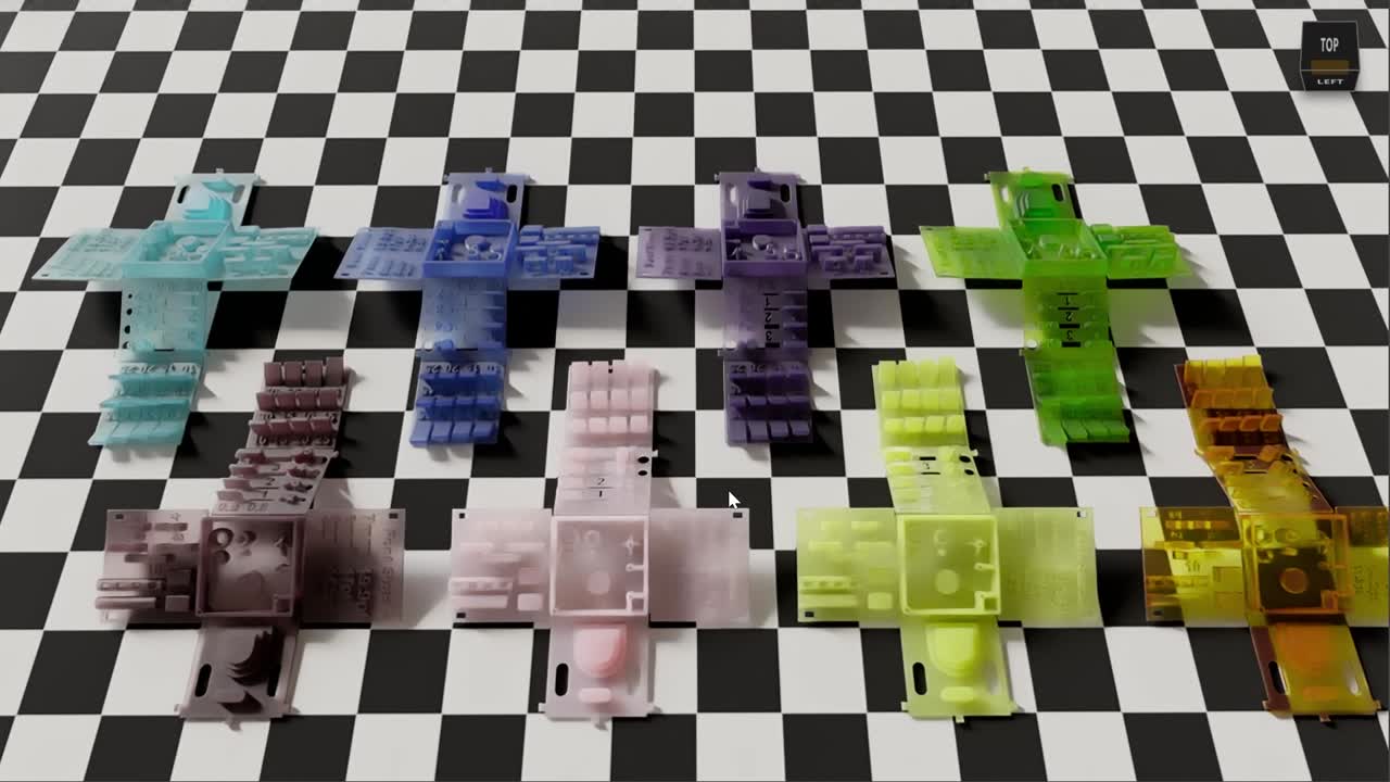

Translucent AxF Material
VRED now supports translucent X-Rite AxF materials with or without surface roughness. This is particularly useful for colored translucent plastics with a clear or matte appearance, like those in the consumer product sector, as well as tail- and headlights, or decorative elements in the automotive sector. Their realistic representation and simulation can be particularly challenging, as color, reflection, refraction, light absorption, or volume scatter effects are often based on artistic impressions or cannot be represented in standard materials. The support of translucent AxF materials offers an ideal extension to deliver more physically accurate results and eliminates false assumptions in the material generation pipeline.
Please note, translucent AxF materials are only displayed correctly in raytracing. Furthermore, AxF measurements can be spectral. This, in turn, requires spectral rendering in VRED to accurately display colors.

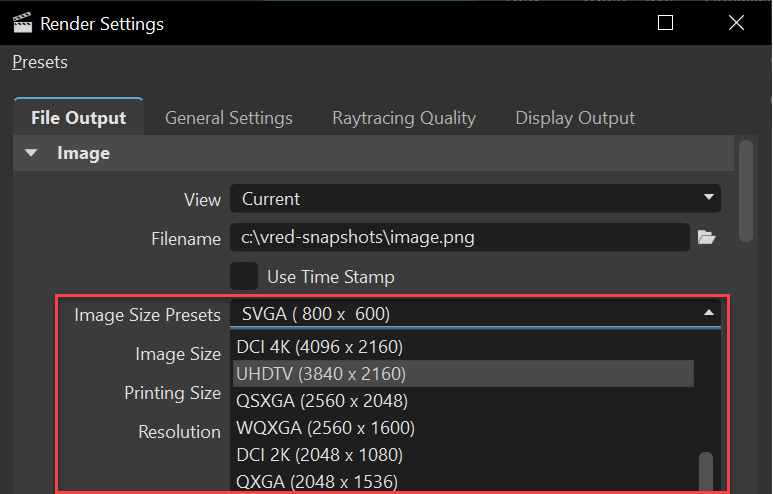

4K UHDTV
We've added a 4K option, UHDTV (3840 x 2160), to the Image Size Presets in the Render Settings > File Output > Image section.
UHDTV (3840 x 2160)
