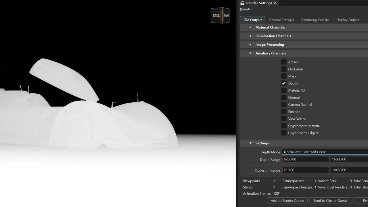

File Output Tab Changes
Image of the Renderpasses section with options
In the Renderpasses section, it is possible to control the minimum and maximum range for the Linear Depth Pass and Occlusion Pass in raytracing. The changes made to these settings will be immediately visible in the viewport. Ensure CPU or GPU raytracing is activated and the corresponding channels from the Visualization menu > Renderpasses Rendering > Auxiliary Channels > Depth/Occlusion are enabled.
Settings
In VRED 2024.2, we added the Settings sub-section to the Renderpasses section and options for generating the depth pass in a linear scale, either using world space (Linear) or within a specified range (Normalized Linear & Normalized Reversed Linear), independently from the camera near and far clipping plane settings (Standard). Use depth of field or fog in post processing. Use Occlusion Range for tweaking contrast of creases in post processing.
Settings
  • Depth Mode - Sets the way the depth pass is calculated. Choose from:
    • Standard - Writes a 1/z calculation, based on the OpenGL depth buffer calculation, to the depth pass. The near plane clipping maps to white, while the far clipping plane maps to black.
    • Linear - Writes a world space depth value to the depth pass.
    • Normalized Linear - Writes a linear depth value to the depth pass. The minimum value maps to black and the maximum to white.
    • Normalized Reversed Linear - Writes a reversed linear depth value to the depth pass. The minimum value maps to white and the maximum to black.
  • Depth Range - Sets the depth minimum and maximum values when using either the Normalized Linear or Normalized Reversed Linear depth mode.
  • Occlusion Range - Sets the range used for the ambient occlusion calculation. Use this to tweak contrast of creases in post processing.
