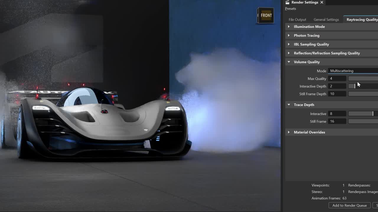

Multi-Scattering Support for Volumes in Raytracing
When multi-scattering is enabled, traversal optimization is automatically used. For a ray entering a volume, a search for the entry and exit point is done. For each scatter event, a search for the new exit point is done, which significantly speeds up multi-scattering.
With VRED 2025.1, there are now two approaches for rendering volumes, ray-marching or multi-scattering. Multi-scattering provides a more physically accurate result, as it takes into account the scattering of light and color within the volume.
Ray-marching (2025) Multi-scattering (2025.1)
Ray-marching rendered volumes Multi-scattering rendered volumes
However, it is more computationally intensive and requires more samples to converge to achieve a noise-free result. Therefore, it is currently only available for Raytracing.
Find this option in Render Settings > Raytracing Quality tab > Volume Quality > Mode.
