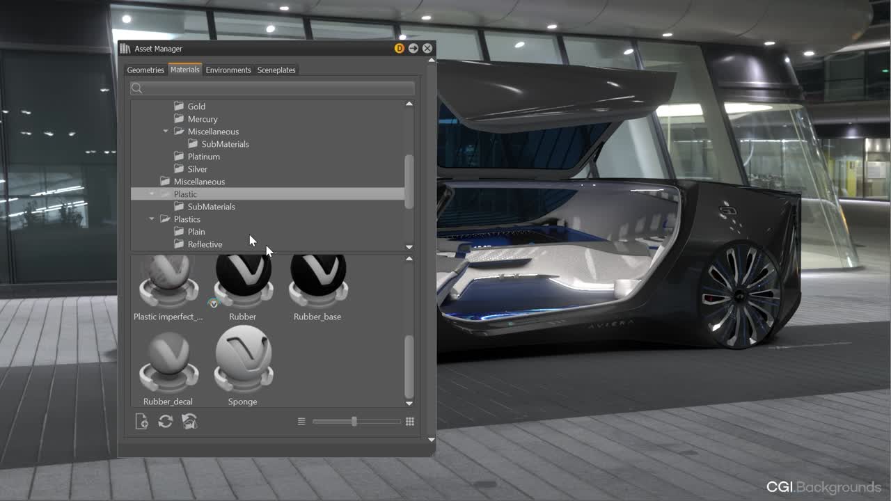

The Asset installer brings multiple new great asset materials, such as asphalt, clay, used plastic or concrete, and a ton more. You can access them by downloading and installing the separate VRED Asset installer. Now, you can access them from the Asset Manger and drag them into the scene. See a complete list of the new materials on the documentation.
When creating your own material assets, we have added an option within the preferences, which lets you write textures of the material as an external separate file, instead of inlining them within the OSB file of the material asset. This saves disk space massively, as the inlined textures in the OSB file would normally be stored uncompressed, compared to the external one.
