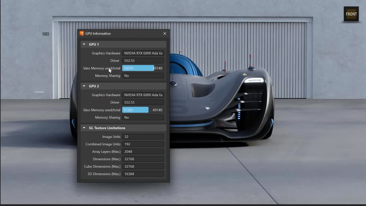

The GL Info window is now renamed to the GPU Information and has a reworked UI for a quicker overview of the important information, like the driver versions and memory usage.
