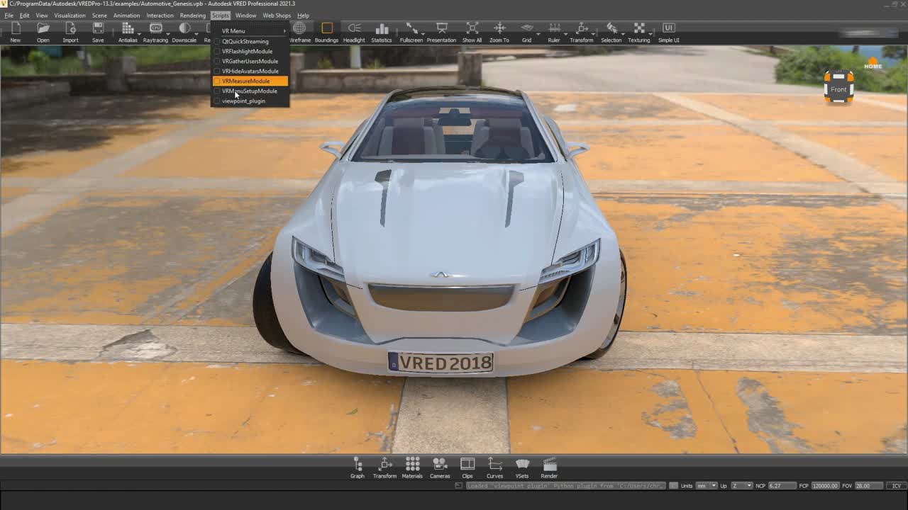

So, maybe you wonder, why should I ever start scripting in VRED with Python? Well, VRED offers an extensive API, which gives you access to all functions it has to offer. You can access all data and you can manipulate any data you like and Python is basically the tool that allows you to unlock all these possibilities. You can just play around in the terminal, try functions and see how they change your scene. You can install small scripts and variant sets that execute when the variants set is triggered, or you can write more complex scripts in the Script Editor. You can develop plugins with custom interfaces that basically can change the whole way you work with VRED and share them with your coworkers. Or you can build up an automatic rendering or data preparation pipeline that can prepare CAD data for you. Well, you see, the possibilities are nearly endless. If this sounds a lot to take in, don't worry. We will cover each of these possibilities in several tutorials. And step-by-step, you will get to know VRED's Python interfaces and learn how to work with them.
Maybe you're thinking right now, okay, when I can do everything with Python, then where do I start? When you open VRED, you find an entry for all kinds of examples under File in the Menu bar. You will find a lot of example Python scripts to all kind of topics. For example, you find scripts on how you can create and manipulate scene plates, how you can write script plug-ins, or how you integrate custom menus in VRED. This example here shows how you can create transformation constraints for objects. When we open the example, we find a few geometrical primitives and a text added as a scene plate. When we hit C and move, for example, the red ball, we see that all objects are connected in some way.
The Python magic happens in the Script Editor. Here's all the code that is responsible for this behavior. The code is automatically executed when you open the scene. Most of the example scripts have their own code added in the Script Editor. So I can only recommend to have a look at the some of these examples. Try them out and also try to understand what is happening here. While exploring the examples, you can look at unknown functions and modules in the documentation. VRED also offers these examples on their website. They have lots of resources there if you want to learn something, and we will add a link to them in the description. When looking at these example scripts, you can see lots of identifiers that you might not be familiar with, like vrnodeservice or createaimconstraint.
