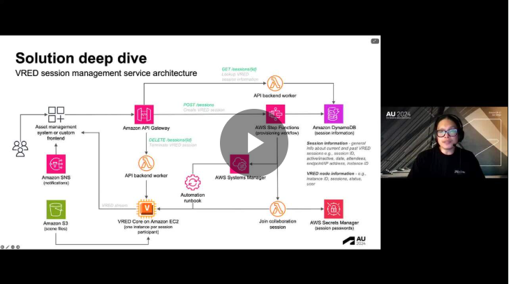

This session will share details of a project called the VRED Session Management Service (VRED SMS). A prototype built by solutions engineers working together from Autodesk and Amazon Web Services (AWS), VRED SMS demonstrates how VRED 3D visualization software from Autodesk can be deployed and scaled on AWS in an on-demand way. VRED SMS allows applications that can interface a REST API to request a VRED collaboration session. Automated workflows execute to prepare the requisite instances and VRED configuration for a requested VRED scene file. This solution comprises a variety of AWS services, including but not limited to EC2 Image Builder, AWS Step Functions, AWS Systems Manager, AWS Secrets Manager, AWS Lambda, Amazon S3, Amazon DynamoDB, and Amazon API Gateway. It is also deployed using AWS Cloud Development Kit (AWS CDK). To automate the configuration of Autodesk's VRED software, this solution uses its Python and web APIs. The programmatic and workflow-driven nature of the solution makes it relatively simple to customize.
