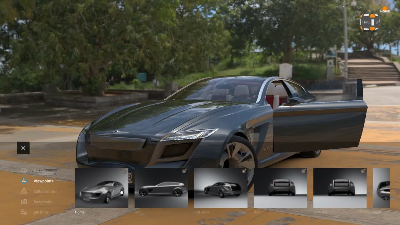

You already might be familiar with VRED's Web Interface and how can use it. When activated, VRED starts a web server that hosts a web app to remotely control VRED with a browser. It’s perfect for design reviews or customer presentations because you can move the camera, have a live video stream, and can trigger any variant sets you have defined.
To enable the Web Interface you have to go to the Preferences and scroll down to WebInterface. Here you can enable the Web Interface. When you apply the changes, you are basically ready to use the Web Interface on your local host. But when you want to have access with an iPad, for example, you will have to set the Host Access to either “no restriction” or add your iPad to your host list with its IP address.
For testing, it's totally fine to set the host access to “no restriction”, but for security you should always work with a host list. When you are in the same network, you can just enter the IP address of the device you are using, and you can connect to the Web Interface. There are some other settings and I will not cover them all in this tutorial, but all the settings are explained in the online documentation for the WebInterface preferences.
Right now, I’m connected to the VRED scene with my iPad and you see I can control the scene with my fingers and switch between the variant sets. I can take snapshot, change the settings, and so on. So, when you want to do a simple presentation, these features would probably be enough. But the VRED streaming app also makes it possible to directly enter a Python script that is then executed in the Terminal. There is already an example here that creates new scene and adds a box to the Scenegraph.
