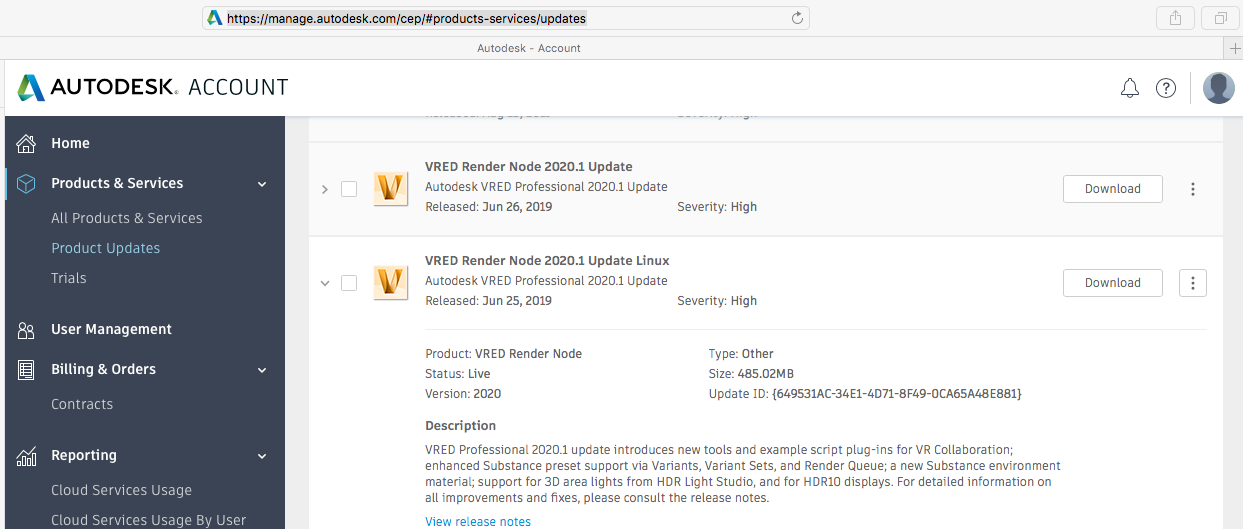

The VREDCluster for Linux, also called VRED Render Node for Linux, is available only from the Accounts portal at (https://manage.autodesk.com).
If you go to (https://manage.autodesk.com), in the Products & Services > Product Updates, look for VRED Render Node 2020.1.1 License Bug Fix (VREDCluster-2020.x-LicensePatch.zip).
Where to find patches and updates
This zip file contains two shell script files, VREDCluster-2020-12.0-LicensePatch.sh and VREDCluster-2020.1-12.1-LicensePatch.sh.
Installing the VREDCluster 2020 and 2020.1 Patches on Linux
To install the patches, open a terminal, go to the location of the VREDCluster-12.x folder, and execute the shell scripts, VREDCluster-2020-12.0-LicensePatch.sh and VREDCluster-2020.1-12.1-LicensePatch.sh, from that location.
