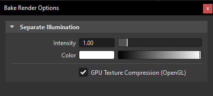

    Bake Render Separate Illumination Options
    Bake Render Separate Illumination Options dialog
    • GPU Texture Compression - Enables GPU texture compression for lightmaps to reduce memory consumption on the GPU. If any compression artifacts become visible when 3D rendering, disable this option. Currently, only separate lightmaps are compressed.
      Note:
      Activating the compression can take a while, depending on the number of separate lightmaps and their size, as textures are compressed and uploaded to the GPU.
      Artifacts might be more visible when viewing the raw texture data with Visualization > Precomputed Illumination Rendering, but less visible in Realistic Rendering, depending on how the lightmap data is combined with other real-time light (e.g., from the environment).
    Tip:
    For Python users, try this script: setLightmapGPUTextureCompression(on)
    • Intensity - Controls for changing the intensity of all separate lightmaps. Use it to turn lights on and off or dim and brighten them. You can use scripts to create Variant Sets.

How to Control the Intensity of the Separate Illumination
Bake white light, such as an ambient light for a door panel, into your scene and change the intensity in real-time.
  1. Create a separate illumination lightmap for the ambient light:
    • For a light, with the light selected, in the Bake Light and Shadows module Bake Settings tab, select Ambient Occlusion and enable Enable Separate Illumination. Click Calculate All.
    • For a geometry light source, with the geometry selected, in the Material Editor, select it material, then in the Incandescence section, enable Bake as Separate Illumination and Use as Light Source (Raytracing Only). In the Bake Light and Shadows module, click Calculate All.
  2. Select Visualization menu > Bake Render Options > Separate Illumination Options to access Intensity.
  3. Use the Intensity slider to change the brightness of all separate illumination lightmap.

How to Control the Color Multiplier for the Separate Illumination Map
Bake white light into your scene, such as an ambient light for a door panel, and change the color with the multiplier in real-time.
Note:
At present, you cannot build light classes to change the intensity or the color multiplier for the separate lights individually and control, for example, a "red" light independent from a "blue".
  2. Select Visualization menu > Bake Render Options > Separate Illumination Options to access Color.
  3. Click the color swatch or move the slider to multiply the light with a color to change it.
