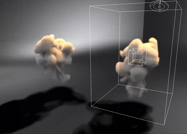

  • Volumetrics raytraced reflections, when Reflect Volumes is enabled. Since these can slightly effect performance, they can be disabled. When playing back an animated volumetric reflection, enable DLSS to correct any lag in the reflected playback.

    For Vulkan, we added support for Shadow material raytraced glossy reflections, Volumetrics raytraced reflections, OCS materials, and glow and glare, chromatic aberration, camera grain, vignetting, and camera blends in Display Clusters. For a complete list, see Vulkan - New Features and Improvements.
