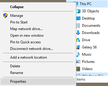

  1. Right-click your This PC icon and select Properties.

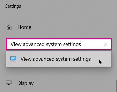

    Windows Properties option
  2. Enter View advanced system settings in the search field and press Enter.

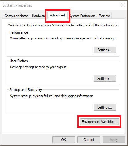

  3. Click the Advanced tab, then the Environment Variables button.
    System Properties dialog

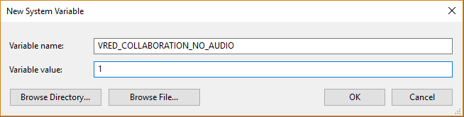

  4. In the System variables section (at the bottom), click New. This open the New System Variable dialog.
  5. Enter the environment variable name and a value, then click OK and OK again.
