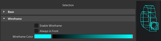

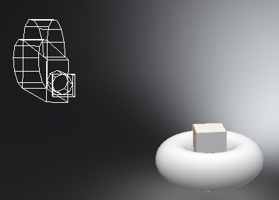

In the Menu Bar, select View and enable Show Cameras. Disable it to hide all cameras.
  • When a camera is not selected, it appears white.
    Unselected

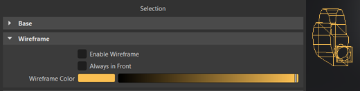

  • When you hover over it, it takes on the Preselection Color preference color.
  • When selected, it takes on the Wireframe Color preference color.
    Camera selectedCamera selected 2
    Note:
    To change either the Preselection Color or the Wireframe Color , in the Menu Bar, select Edit > Preferences > General Settings > Selection.

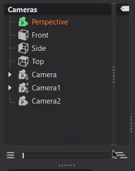

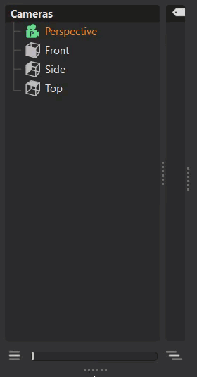

Opening a Second Tree
Open a second tree for searching and filtering cameras, viewpoints, and tracks. One tree is unaffected by changes in the other.
  1. In the Camera Editor, click-drag Section Drag to expose a second tree list.
    Section Drag
  2. Now, use the new tree for searches and filtering.
Tip:
Drag the slider at the bottom of the tree or click its buttons to expand and collapse the tree list.
Collapsed and expanded tree
