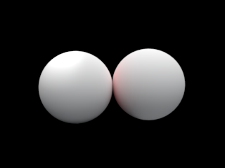

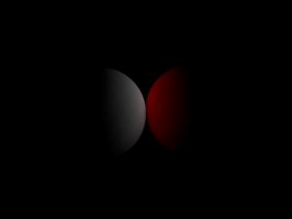

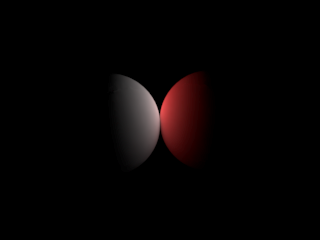

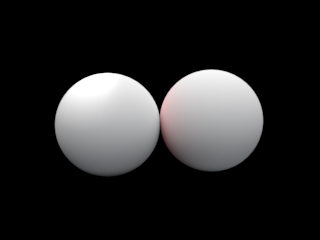

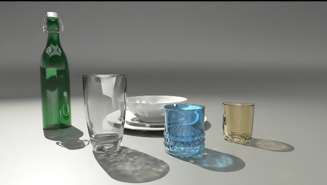

Caustics (Render Settings > Raytracing Quality > Photon Tracing > Mode) can be baked as part of indirect illumination, preferably with more than 16 indirections. The number of indirections is essentially an override of the Trace Depth (Render Settings > Raytracing Quality > Photon Tracing > Trace Depth) of the raytracer during baking.
Caustics example
Though it may take longer to calculate and requires more work upfront, the texture bake type delivers a more accurate result than vertex, without affecting the geometry. It is especially good for shadowing of anything with fine detail that is hard to display with vertex baking. Photon mapping can be used to improve difficult lighting scenarios and is also a requirement for baking Ray Lights.
Photon mapping example

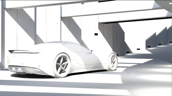

Precomputed Illumination Rendering for Light and Shadows
The content in the table below provides the visible differences seen with Precomputed Illumination Rendering when lights and shadows are baked, based on your render mode and whether vertex or texture baking. Use Precomputed Illumination Rendering to preview what has been baked.
Precomputed Illumination Rendering example
For example, if you are in rasterization and have baked lights and shadows using texture baking, the Precomputed Illumination Rendering mode will display baked direct light and baked indirect light if it was enabled.

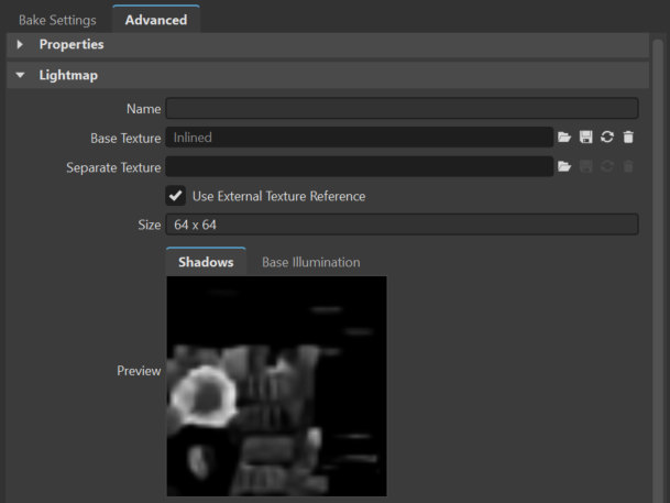

Base and Separate Texture
In the Bake Light and Shadows module, within the Lightmap section of the Advanced tab, you can use Base Texture and Separate Texture to load .exr files for the new lightmap textures.
Important:
IMPORTANT: Only images stored with VRED will have the correct mode and settings. All other images created with other software may result in an incorrect rendering result.
