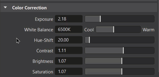

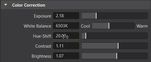

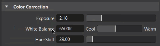

Enable Mouse Scroll Wheel Value Changes - When enabled (the default state), the scroll wheel modifies data when used on combo boxes, sliders, or spin boxes.
However, keep in mind that this can also lead to unwanted data modification while using the scroll wheel.
When disabled, control or field values are not modified when using the scroll wheel.
The wheel will only scroll through your view of options. Therefore, controls that only alter the view and do not modify scene data, such as sliders for scaling the Material Preview list or for expanding/collapsing the various trees, will still react to the scroll wheel.
