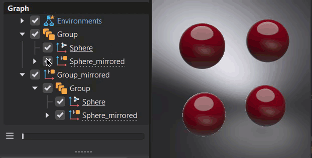

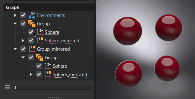

Sync Visibility of Clones - Toggles the syncing of clone visibility on or off and ensures the visibility of clones is synced, when enabled. See Clones for use.
Tip:Click Apply and OK after either enabling or disabling this functionality for it to work.
When enabled, the clone node visibility cannot be toggled off independent of the original object node.
When disabled, which is the default setting, the clone node visibility can be toggled off independent of the original object node.

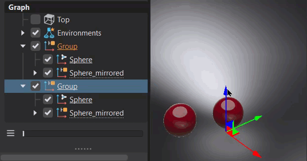

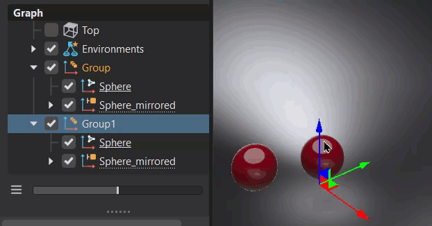

Transformable Clone Root - Toggles the transformation of a clone root on or off. This must be set before the clone is created. See Clones for use.
When enabled, which is the default setting, the clone root can be transformed (moved, scaled, and rotated) independent of the original object node.
When disabled, the clone root node cannot be transformed independent of the original object node.
