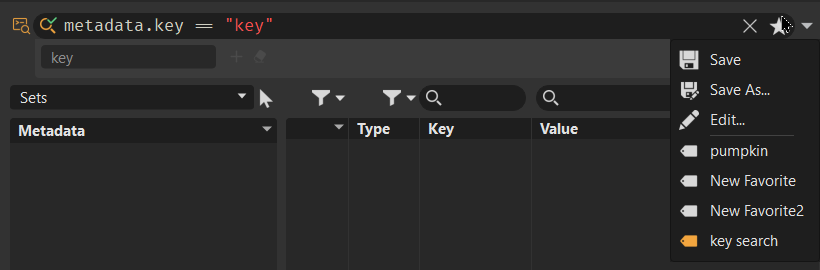

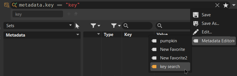

Options in this section influence the behavior of the advanced search favorites.
Menu Structure - Select the default behavior of the Favorites menu structure. Choose from Grouped and Flat.
Grouped - Displays all favorites in the Favorites menu grouped in a folder.
Flat - Displays all favorites in the Favorites menu as a list.
