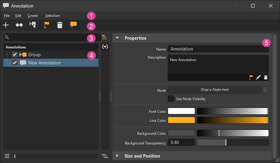

2 QuickActions Bar
  • Create annotation Create - Creates an annotation node in the list view. In your scene, shift-click to select a location for the annotation and use the Description section to add your annotation.
  • Duplicate icon Duplicate (Ctrl + D) - Duplicates all selected annotations. Duplicates are created on top of the originals, so use Reposition icon Reposition to position them elsewhere.
  • Select Nodes icon Select Nodes (Ctrl + N) - Select nodes in the Scenegraph associated with the selected annotations.
  • Reposition icon Reposition - Relocates the selected annotation, once you shift-click in a different location in the scene.
  • Delete icon Delete (Del) - Deletes the selected annotation from the List View and removes it from your scene. You can remove all or a range of annotations. See How to Remove Annotations for details.
  • Toggle Annotations icon Toggle Annotations - Shows or hide annotations in your scene. You can also click the check box next to any annotation in the List View to hide its display.

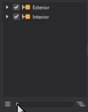

4 List View
The List View displays all annotations, which can be grouped and toggled on to display or off to hide by checking or unchecking the box next to an annotation or group.
Right-click an annotation to access the context menu containing options for creating, grouping, repositioning, duplicating, selecting nodes, deleting, and toggling annotation display, editing a description, zooming to an annotation, as well as loading and saving annotations.
Expansion Column
To the right of the List View is a column which displays an icon Live Reference icon, visually indicating a Live Reference node. Double-clicking the icon opens the Live Reference module, with the node selected. Pull the grip to expose this column, if not visible.
Live Reference expansion column
Slider
The slider and its buttons are a fast way to expand or collapse the sub-structure of the selection or multi-selection. With nothing selected in the List View, all nodes are expanded.
Click Collapse icon to collapse the hierarchy of the selected node or Expand icon to expand it.
Use of slider for expanding and collapsing the List View tree
5 Attributes
Use these sections to customize annotation text, font and background color, as well as size and position.
Properties
Contains options for adjusting the font, line, and background color, and background transparency, as well as these:
  • Name - Identifies an annotation when using Python.
  • Description - Use this field to enter and edit annotation text. Right-click for options to undo, redo, cut, copy, paste, copy link location, delete, and select all. When finished, the annotation updates in the List View and your scene.
  • Node - Identifies the Scenegraph node associated with the annotation. Drag and drop the Scenegraph node you want associated with this annotation onto this field. To remove the association, click Delete icon. To change the node assigned to the annotation, drag a different one from the Scenegraph onto the Node field.
  • Use Node Visibility - Uses the visibility state of the associated node for the annotation. When Use Node Visibility is enabled, if the node is invisible, so is the annotation. If the annotation has no node association, Use Node Visibility has no effect.
  • Font Color - Sets the color used for the annotated text.
  • Line Color - Sets the color used for the line leading to the annotated text.
  • Background Color - Sets the color of the annotation's background.
  • Background Transparency - Sets the transparency of the annotation's background.
Size and Position
Adjust the position and size of the annotation.
  • Anchor to Node - Determines whether an annotation moves with the changing relative position of its associated Scenegraph node. If the node is transformed, the position of the annotation adapts accordingly (as the annotation's position is always calculated in world coordinates).
    Video Player is loading.
    Current Time 0:00
    Duration 0:39
    Loaded: 0%
    0:00
    Progress: 0%
    1x
  • Position - Sets where the annotation appears on screen. Enter an x, y, and z position. To manually position the annotation, enable Repositioning icon, then Shift-click elsewhere on the screen.
  • Size - Sets the size of the annotation. Increasing this increases the annotation bubble and font size.
  • Dynamic Scaling - Enables size variation of labels based on their depth within the Render Window. For example, an object's label appears closer in the Render Window and is larger than that of an object further back. There are three scaling options:
    • Near - Makes the closest labels smaller, which is appropriate when working close to the screen.
    • Far - Makes labels further away larger, which is appropriate when working far from the computer screen. This is good when sharing a presentation with others.
    • Off - Makes labels larger, but the same size.
      Since both Size and Dynamic Scaling affect annotation size, use them in combination to get the right size.
