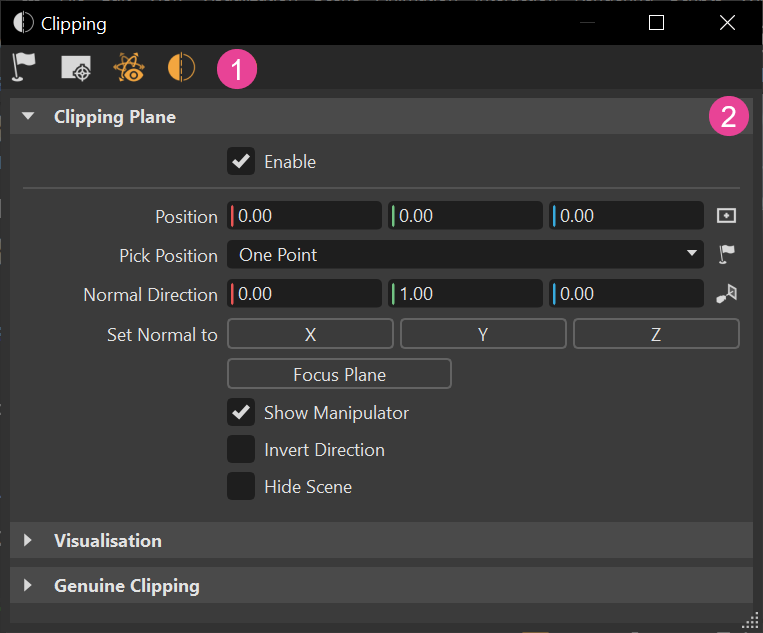

The Clipping module contains a toolbar and three sections.
Toolbar

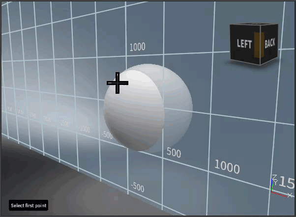

Pick Position - Only available when Enable Clipping is enabled. Changes the positioning of the clipping plane. Click Pick Position, follow the prompt(s) in the bottom left corner of your screen, using Shift-click to select any point.
Focus Plane - Only available when Enable Clipping is enabled. Changes the view displayed to the focus plane.Original View Focus Plane View

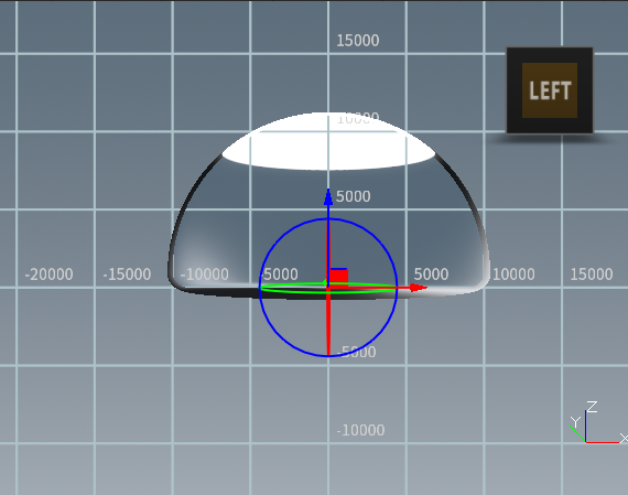

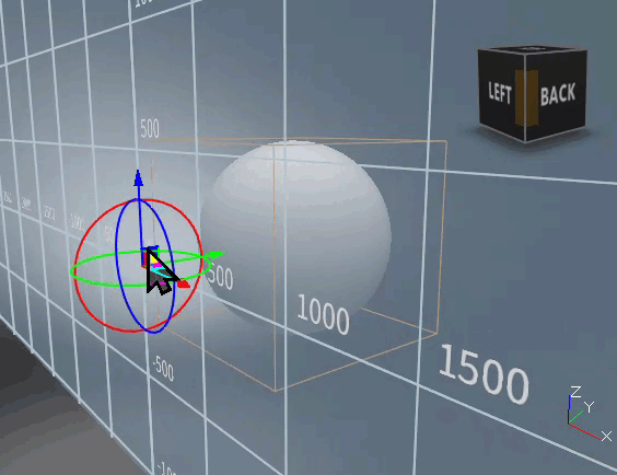

Show Manipulator - Only available when Enable Clipping is enabled. Displays the clipping plane manipulator, when enabled.
Enable Clipping - Displays the clipping plane, when enabled.Disabled Enabled
Sections
Clipping Plane
These options are for making changes to the positioning of the clipping plane.
Enable - Displays the clipping plane, when enabled.
Position - Repositions the clipping plane. Click
to position the center of the clipping plane at 0,0,0.Pick Position - Enables the picking of points in the render view to reposition the clipping plane. Use the dropdown for choosing the number of points required for repositioning the clipping plane. Click
and use Shift-click for selecting points and follow the prompt(s) in the bottom left corner of your screen.

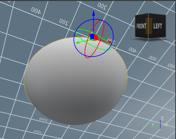

Normal Direction - Sets the direction of the clipping plane surface normals. Click
to set the normals facing the camera axis.Before After
Set Normal to - Flips the clipping plane and its normals to face the selected axis.
Focus Plane - Changes the view displayed to the focus plane.

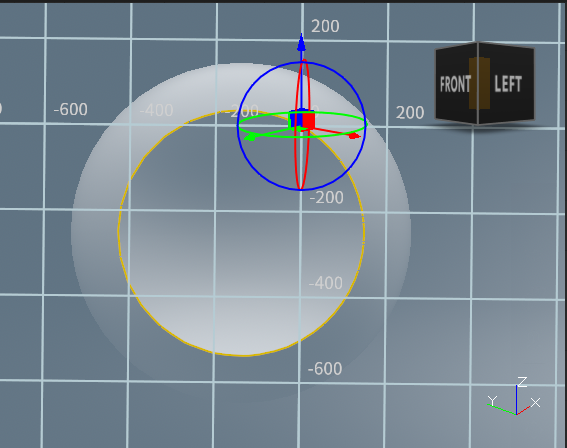

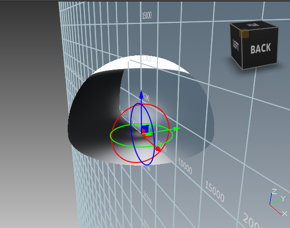

Show Manipulator - Displays the clipping plane manipulator, when enabled.
Invert Direction - Inverts the clipping plane by flipping its normals to face the opposite direction.
Original Inverted
Hide Scene - Hides the scene in the render view to only display the clipping plane.
Original Hidden

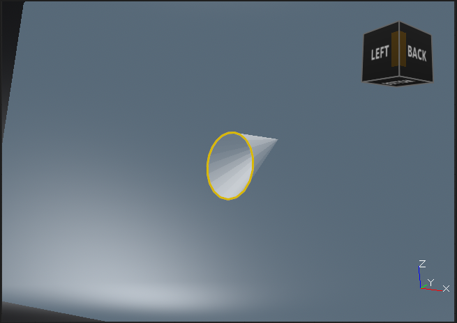

Show Clipping Plane - Displays the semi-opaque clipping plane, when enabled.
Clipping Plane Shown Clipping Plane Hidden

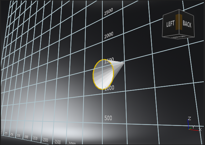

Plane Color - Sets the color of the visible clipping plane.
Original Color New Color

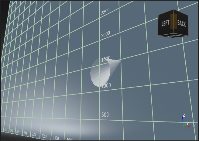

Show Grid - Displays the clipping plane grid, when enabled.
Grid Shown Grid Hidden

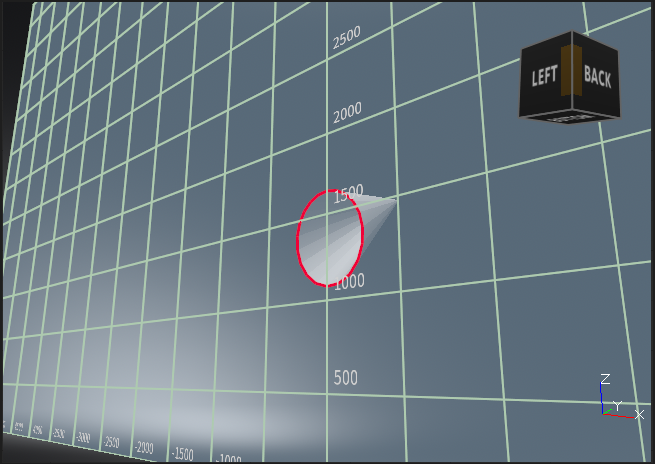

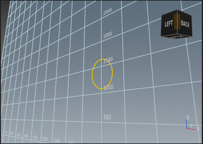

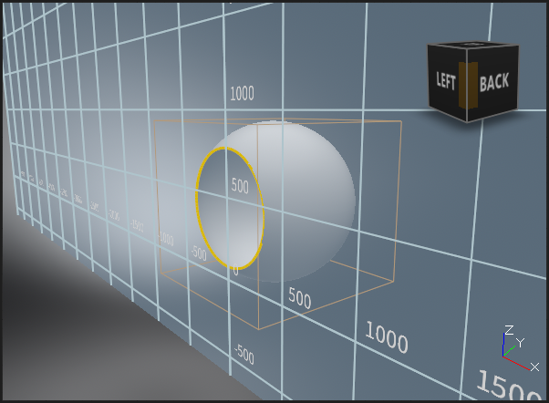

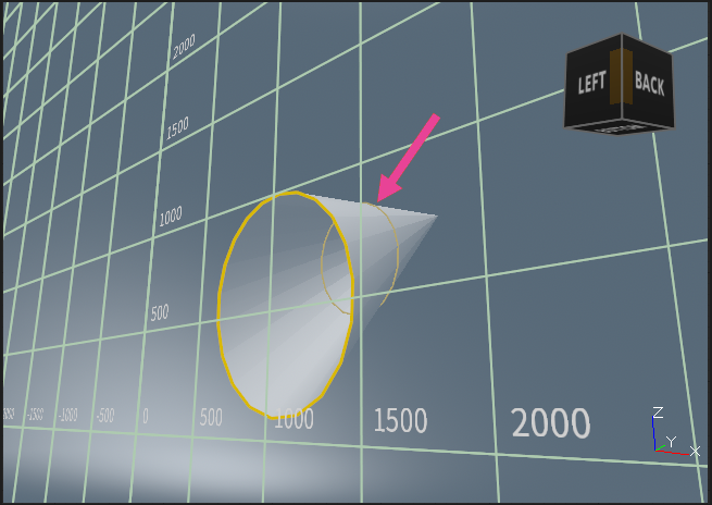

Show Contour - Displays where objects are intersected by the clipping plane.
Contour Shown Controur Hidden
Contour Color - Sets the color of the contour.
Contour Width - Sets the width of the contour line.
Width = 3 Width = 20

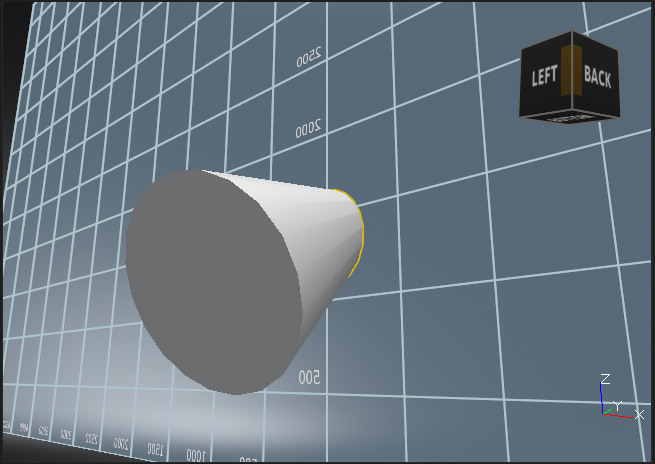

Clone Contour - Creates a clone of the contour line. If the clipping plane is repositioned, this clone remains where it was created.
Original Hidden
