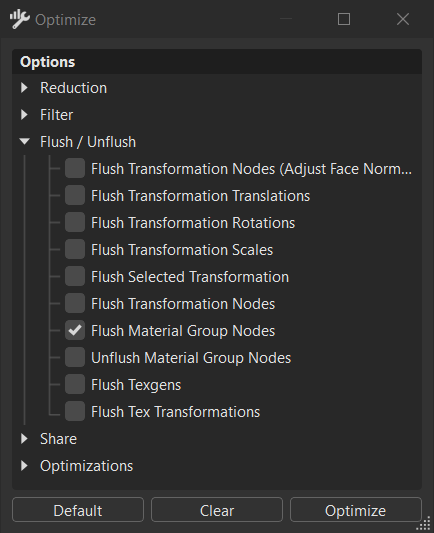

Flush/Unflush
Use Flush after bringing a model into VRED and transforming it to fit into your scene. Flush keeps the new orientation, while resetting all the transformations to zero, making the new orientation of the model the default.
Object transformation can be realized two different ways within the Scenegraph. Either the transformation is stored within the object itself (flushed) or the related information is stored within group nodes on a higher hierarchy level above (unflushed). Nodes that contain transformations have a symbol of an axis in front of their icon Axis icon. Several transformations on different levels are accumulated. Nodes containing transform variants and their parent nodes will remain unaffected by the Flush Transformation functions. To flush these nodes, enable Filter - Remove Transform Variants.
  • Flush Transformation Nodes (Adjust Face Normals) - Moves transform information from transform nodes to the geometry nodes on the lowest level. Face normals are recalculated upon execution.
  • Flush Transformation Translations - Moves the translation-related transform information of the selected sub-tree to the geometry nodes on the lowest level.
  • Flush Transformation Rotations - Moves the rotation-related transform information of the selected sub-tree to the geometry nodes on the lowest level.
  • Flush Transformation Scales - Moves the scale-related transform information of the selected sub-tree to the geometry nodes on the lowest level.
  • Flush Selected Transformation - Flushes transform information from selected node.
  • Flush Transformation Nodes - Moves the transform information of the selected sub-tree to the geometry nodes on the lowest level.
  • Flush Material Group Nodes - Material assignment in VRED can be done by assignment to the object itself or to a material group node on a higher hierarchy level. Execution moves unflushed material definitions from the material group node of the object.
  • Unflush Material Group Nodes - Creates a material group node above each geometrical node within the selection and moves the material definition there.
  • Flush Texgens - Converts TexGenChunk information to texture coordinates within the object on the level below.
  • Flush Tex Transformations - Converts TextureTransformChunk information to texture coordinates within the object on the level below.
