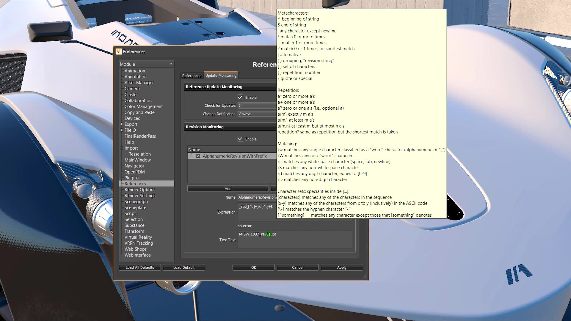

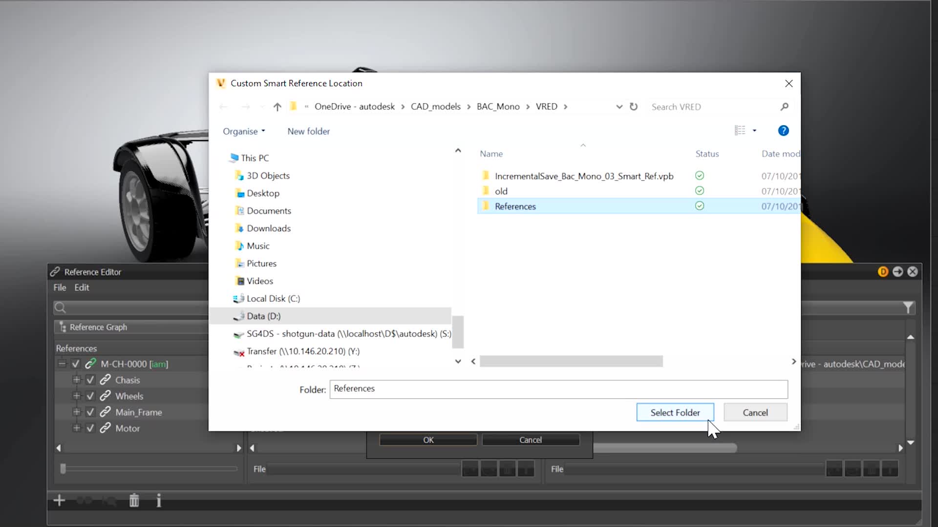

References Video Captions: Convert and create smart references from one or multiple selected nodes. All smart references and source files can be tracked under Scene > Reference Editor. Once you save the file, VRED asks where to store the newly created smart references. You access them through the defined folder. When working on a single smart references within VRED, when you save the file, the Reference Editor of the main assembly will recognize that a file is out of date. You can reimport the files, if needed. Also, changes to the source file, like here in this Inventor files, will be recognized, and you can update or reimport it within your VRED file. With the new Reference Editor, we are enabling better teamwork and simplifying the collaborative workflow massively.

In 2020.2, they have their own unique icons and naming to differentiate them from other nodes, and update monitoring was added.

Smart References
Example of a smart reference
Smart references are native to VRED and only support VPBs and OSBs. Their content is stored in an external file. When changes are made in the project files, the link to this external file is maintained. This is for monitoring and if reimport is needed.
Use smart references for dividing a large project into smaller VPB files. This way, large teams can work in parallel. Team members can work on individual files without loading the entire project. This minimizes increases to the main project's file size. Also, smart references can be loaded and unloaded without the need to reimport the source file, which is great for maintaining scene performance.
Smart-Source References
Example of a smart-source reference
Smart-source references are a hybrid of the two references. They provide a link between a smart and source reference file. The smart references are generated from their source references and can be stored alongside the source file locations. They can also by stored in a custom location. Users can monitor both files at the same time and see if one or both are out of date or missing.

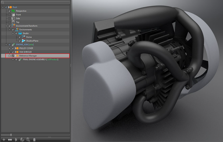

Importing Alias Reference Assemblies
We added the importing of native CAD file assembled in the Alias Reference Manager directly into VRED 2022. A new Reference Manager group node will be created in the Scenegraph to mimic the Alias Reference Manager and layers.
Alias 2021 introduced the possibility to create an assembly structure from various CAD file formats, such as .wire, .iges, .step, etc. Alias creates an intermediate .wref reference file for modeling and visualization purposes in the viewport, while keeping the link to the original CAD file in the background. When importing an Alias .wire file containing an assembly structure into VRED, the linked CAD files are now imported, as well. Find these imported assembled files under the new Reference Manager group in the Scenegraph.
Alias References and Assemblies
