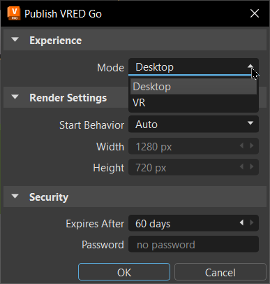

Publish VRED Go dialog
Use this dialog to set the type of viewing experience, render settings, and security measures for the VRED Go executable.
Experience
This section contains viewing mode options.
Mode
Sets the view used for the scene. Choose from VR and Desktop. VR files can be viewed in Desktop mode, if a supported VR device is not detected. See VRED Go Limitations for VR setup instructions.
Render Settings
This section contains options for setting the window behavior and size.
Start Behavior
Determines the size of the viewer when opened. Select from Auto, Full Screen, and Fixed Size, which locks the aspect ratio during window resize. Use Alt + Enter to enter full screen for all modes.
Width
Determines the width of the viewer, when Fixed Size is selected. Enter the pixel width of the viewer.
Height
Determines the height of the viewer, when Fixed Size is selected. Enter the pixel height of the viewer.
Security
This section contains options for entering a password and setting the file's expiry.
Expires After
Sets when the VRED Go executable will expire and can no longer be viewed.
Note:
The maximum days is 60 days.
Password
Sets a password the end user will need to access the VRED Go executable.
Note:
A password is not required.

With a scene loaded in VRED, select File > Publish VRED Go. This opens the VRED Go dialog, where you can choose the mode for the experience, render settings, and security features.
Click OK, select a location for the executable, give it a name, then click Save. Publishing (creating a VRED Go executable) can take some time. When finished, an executable is created in the designated location.
