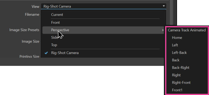

View
View establishes which view is used for rendered image calculation. All viewpoints, pre-defined camera track animations, or variants (if camera was active on its creation) can be selected from the drop-down menu. If a track is chosen, all contained viewpoints are rendered automatically.

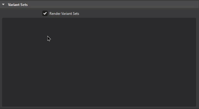

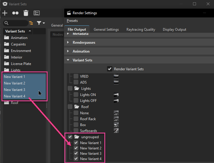

Working with View and Variants

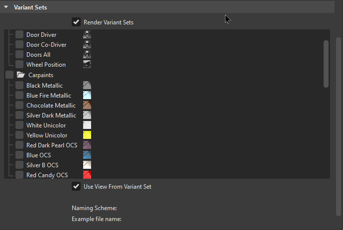

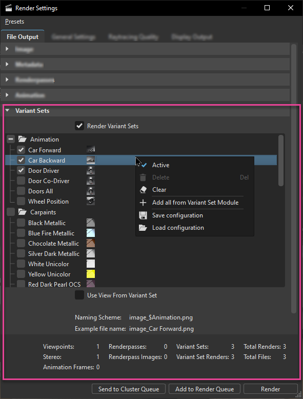

Using View can simplify batch rendering of variant sets by combining viewpoints with variant sets and rendering out images for each combination.
- Select viewpoints with the View option.
 - In Variants, set the variants.
The render session is now made based on the combination of viewpoints with the selected variants. Each output image is named for easy identification. For example, with variants as the naming priority:
Three viewpoints: 45 degree front view, Side view, 45 degree rear view.
( [Front_R_45] [Side_R] [Rear_R_45] )
Three variant trim levels of the car
( [GranTorismo] [Coupe] [StationWagon] )
Resulting rendered image file names:

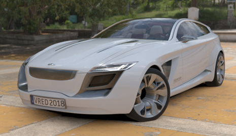

Beauty - Produces a default rendered image. Use it as a comparison image against the final image. The beauty image can be composed from either the Combined channels or Separate channels.

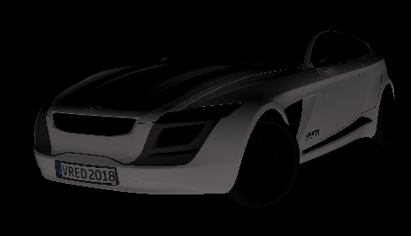

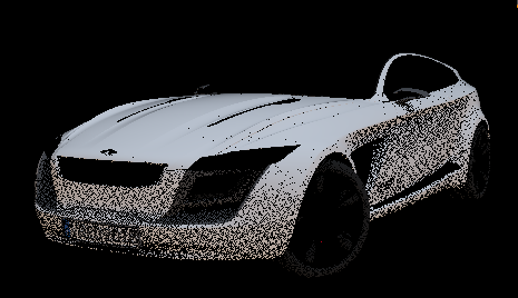

Diffuse Light - Produces an image of the diffuse direct illumination of all light sources in the scene multiplied by the material's diffuse color, such as from a lightbulb.

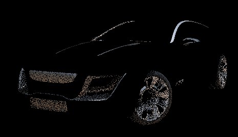

Glossy IBL - Produces an image of the glossy reflections from the active environment in the scene, multiplied by the material's glossy color.

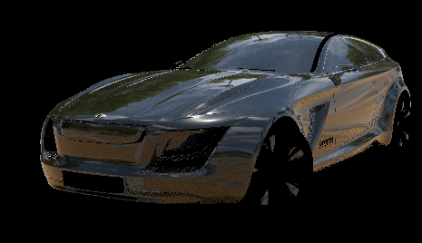

Glossy Light - Produces an image of the glossy reflections from all light sources in the scene, multiplied by the material's glossy color.
Glossy Indirect - Produces an image of glossy reflections from surrounding objects.

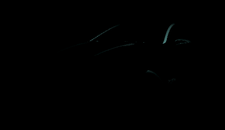

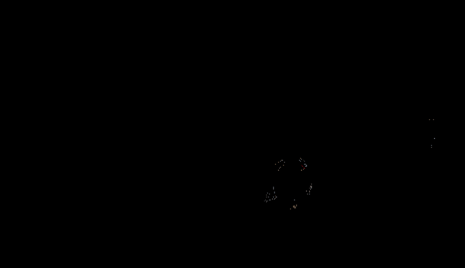

Specular Reflection - Only generates the specular (perfect mirror) reflections from materials like chrome, multiplied by the material's specular color.

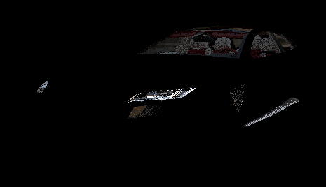

Incandescence - Separates all self-illuninating parts of an image from the rest. Use for adding a glow around light sources when compositing.

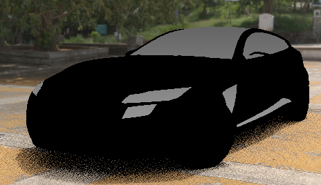

Background Color - Produces a full color image of the background with the opaque geometry black and transparent grey.

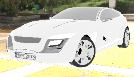

Diffuse Color - Produces an image showing the material's diffuse color.

Lights Diffuse - Produces an image showing the diffuse direct illumination of all light sources in the scene.

IBL Glossy - Produces an image showing the glossy reflections from the active environment.
Lights Glossy - Produces an image showing the glossy reflections from all light sources in the scene.

Indirect Specular - Produces an image showing the specular (perfect mirror) reflections from materials like chrome.

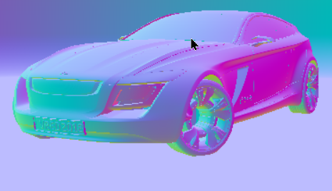

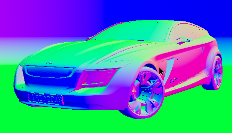

Normal - Produces a colorful image of all 3D shading normals visible in world space. Use it for relighting a scene.

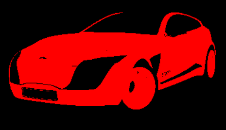

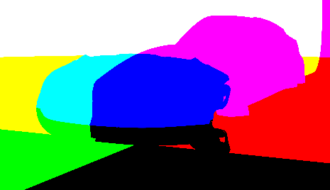

Mask - Corresponds to the alpha channel of the beauty image. This can be used to render the renderpasses without alpha and then add the alpha with the Mask pass in compositing.
Material ID - Use to generate color masks for compositing programs. This pass needs to be adjusted in advance in the material settings of the respective geometry.

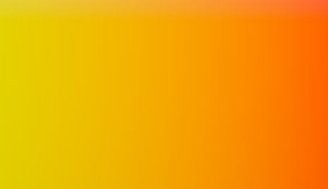

Depth - Produces an image that isolates the scene's depth information. It creates a black and white gradient, based on the distance the objects are from the camera and the camera's near and far plane values. Whites are close to the camera and black is very far.

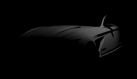

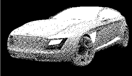

Occlusion - Produces a greyscale image that simulates the self-shadowing in the scene.

Depth Mode - Sets the way the depth pass is calculated. Choose from:
Standard - Writes a 1/z calculation, based on the OpenGL depth buffer calculation, to the depth pass. The near plane clipping maps to white, while the far clipping plane maps to black.
Linear - Writes a world space depth value to the depth pass.
Normalized Linear - Writes a linear depth value to the depth pass. The minimum value maps to black and the maximum to white.
Normalized Reversed Linear - Writes a reversed linear depth value to the depth pass. The minimum value maps to white and the maximum to black.
Depth Range - Sets the depth minimum and maximum values when using either the Normalized Linear or Normalized Reversed Linear depth mode.

Variant Sets
Variant Set Render Video Captions: In VRED 2020.3, we are now able to set and control variant sets within the Render dialog and render out different render set combinations in one go. Just drag the VSets into the new Variant Sets area of the Render Settings. Here you can enable and disable them to define which one to render. Within the context menu, you are also able to store and load the configuration. You can also enable Use View From Variant Set, in case you store a few within the VSet. This is automatically disabled if you choose to render a camera track, under View. Below, you can see a preview of the filenames that will be created. The order of the variant sets will define your filename. At the bottom of the Render Settings, we have added an area, which gives you some useful information, like the total amount of renders that will be created. Once you set up all your variants in the Render Settings, you can also add the complete job to the Render Queue. This new render option will speed up your rendering workflow, immensely, when working with variants and a massive amount of imagery. Thanks for watching the video.
Use the Variant Sets section to easily render multiple versions of a model in VRED. Render a red car in a garage, yellow car in a garage, and red car in park, in one render job. Material and environment variant sets can be set by checking what's wanted and unchecking what's not.
If you reorder groups by click-dragging, this changes the render and naming order of your files. Reordering is not permitted on a per variant set basis, only with groups.
Ungrouped Variant Sets
When ungrouped variant sets are dragged from the Variant Sets module to the Variant Sets section of Render Settings, they will be grouped under the same parent node, named ungrouped. This treats all ungrouped nodes as if they belong to one group to simplify deleting, dragging and dropping, and selecting/deselecting.
Render Variant Sets
Enables variant sets to be added to the render job. Right-click to access a context menu with the following options:
Active - Adds checks to all selected variant sets (materials, geometry, and environments) in the Variant Sets section and adds their information to the Render Summary at the bottom of the module.
Delete - Deletes entire folders of variant sets from the Variant Sets section.
Clear - Clears all variant sets from the Variant Sets section and removes all information from the Render Summary below. To add them back, use Add all from Variant Set Module.
Add all from Variant Set Module - Adds all variant sets in the current scene to the Variant Sets section. Check a variant set to render it. To select everything in a folder, check the folder. To deselect everything in a folder, uncheck the folder.
Save configuration - Saves the configurations as an XML file. This is useful to keep along side your VPB files to get the same rendering results another time.
Load configuration - Reloads the XML configuration file for design reviews, so you have the same results as before.
Use View From Variant Sets - Ignores the viewpoint set in the Render Settings module and uses what was set in the view tab of the Variant Sets module.
At the bottom of this section, the naming scheme and an example file name are displayed. The naming of the rendered files uses a combination of the variant set names to form the final file name. A unique indentifier can be added to the beginning, but only at the time when selecting the render job save location.
