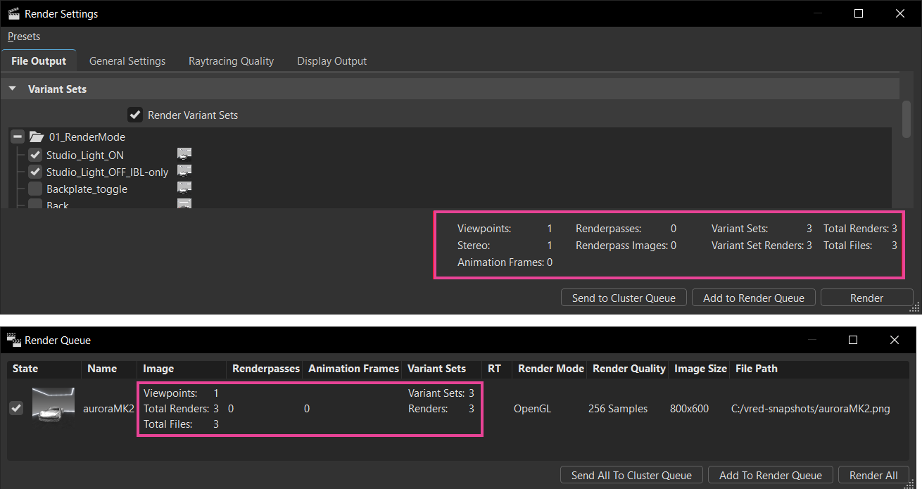

Before using the Render Queue, you will need to set off a render. When in the Simple UI mode, select Render > Render Image or when not, select Rendering > Render Settings, then in the Display Output tab, enter the setting you need. Click the Add to Render Queue button to start image calculations. Enter a name for the rendered image, select where the renders will be saved, then click Save. This opens the Render Queue and adds an entry displaying the state, file name, render mode, quality, image size, and path. Much of the Render Summary data from Render Settings is also displayed.
Render Summary and Render Queue

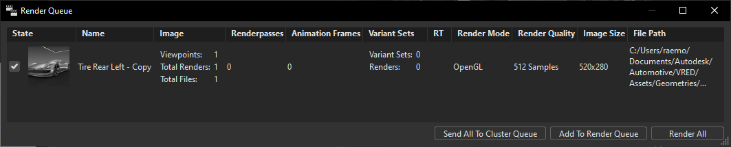

Every line within that queue represents a job that has to be calculated.
Render Queue
Visibility flags assigned to an object by a render layer are captured when something is added to the Render Queue.
Note:
Use this Python command activateRenderLayerState(string name) to activate every stored render layer state with the passed key-name.
  • State - Uses the checkbox to control job consideration on rendering. A preview image helps to identify the jobs within the queue.
  • Name - Shows the name chosen on file browse dialog box.
  • Image - Provides the number of viewpints, total renders, and total files.
  • Renderpasses - Provides the number of renderpasses completed.
  • Animation - Indicates the type of job. Checkbox is selected on animations.
  • Animation Frames - Provides the number of animated frames.
  • Variant Sets - Provides the number of variant sets and renders.
  • RT - Indicates the type of renderer. When enabled it uses Raytracing and Open GL when disabled.
  • Render Mode - Creates the output, based on the setting from the Scene module's Settings tab. It uses the selected image render mode that was configured there.
  • Render Quality/Image Size - Shows the settings set during job creation.
  • File Path - Shows image name and full path.

After configuration is done, the calculation could be either added to the render queue or started immediately by pressing the Render All button. Each option opens the file browser to choose the destination folder and file format.
  • Send All To Cluster Queue - Adds the current scene state to the Cluster Queue.
  • Add to Render Queue - Creates a job from current camera view and adopts the last settings from the Render Image module.
  • Render All - Processes all jobs.
