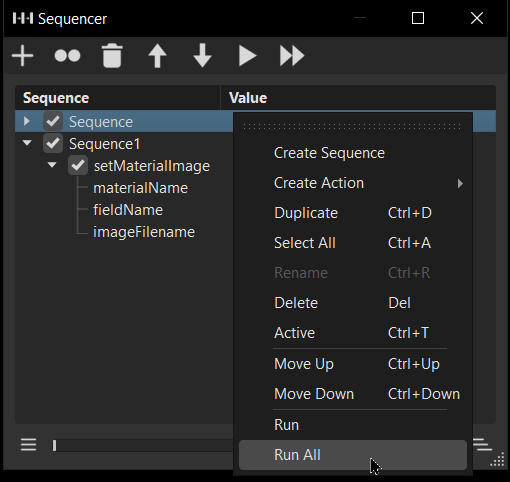

- Select Interaction > Sequencer.
- Right-click inside the Sequencer module and select Create Sequence.
- Right-click the new sequence, select Create Action, then the action you want from the context menu.
- Repeat step 3 to add other actions to the sequence.

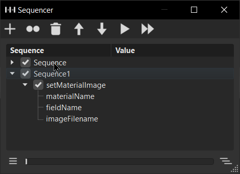

How to Disable an Action Inside a Sequence
To disable an action inside a sequence, deselect the check box beside the action.
How to Use the QuickActions Bar Controls
- Use the controls in the QuickActions Bar to delete, duplicate, or change the order of sequences.
How to Run Command Sequences
To run one sequence, including all its enabled actions:
In the Sequencer module, right-click the sequence you want to run.
Select Run.
To run multiple sequences:
- In the Sequencer module, select the check boxes beside the sequences you want to run.
- Right-click inside the module and select Run All.
