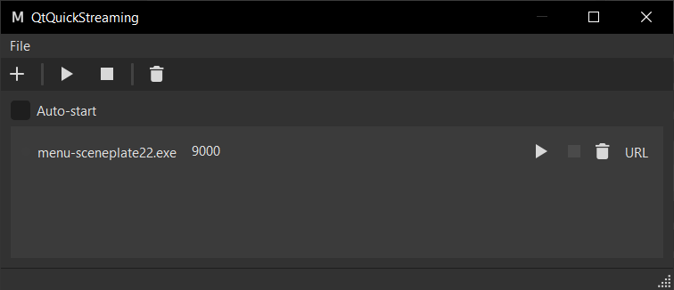

About the QtQuickStreaming Dialog
QuickActions Bar
Use the tools in the Icons Bar for the following:
  • Add an executable Add - Adds a Qt application executable to the list. See step 2 of Playing Streamed Qt Content.
  • Start all processes Start all processes - Starts steaming all processes in the QtQuickStreaming dialog.
  • Stop all processes Stops all processes - Stops steaming all processes in the QtQuickStreaming dialog.
    When VRED terminates, all processes are stopped automatically. Only in cases where VRED crashes without a crash report, will the started processes continue to run. Look for these process in the Task Manager.
  • Delete all processes Deletes all processes - Deletes all processes in the QtQuickStreaming dialog.
Application List
This section of the QtQuickStreaming dialog lists the Qt Quick application executable names, along with the ports used for WebGL streaming. The port number can be changes only when the process is not running (i.e., before it has been started).
These buttons are found next to every executable:
  • Start the process Start - Starts a Qt process.
  • Stop the process Stop - Stop a Qt process.
  • Delete the process Delete - Stops and deletes a Qt process.
  • URL - Copies the web URL of the streaming web server to the clipboard. Use this URL for a WebEngine. See step 4 in Playing Streamed Qt Content.
    For example, create a WebEngine in Media Editor or a frontplate with type Web in the Sceneplate Editor. Paste the copied URL (it should look like: http://localhost:9000 for port 9000) to the WebEngine and press Enter. If successful, you will see the Qt Quick application rendering in VRED on the frontplate or the geometry using the WebEngine.

    1. Select Scripts > QtQuickStreaming to open the QtQuickStreaming dialog.
    2. Click +, locate and select a Qt executable, then click Open. This opens the executable in the background.
    3. In the QtQuickStreaming dialog, the Qt application is displayed, along with the port it is streaming to.
