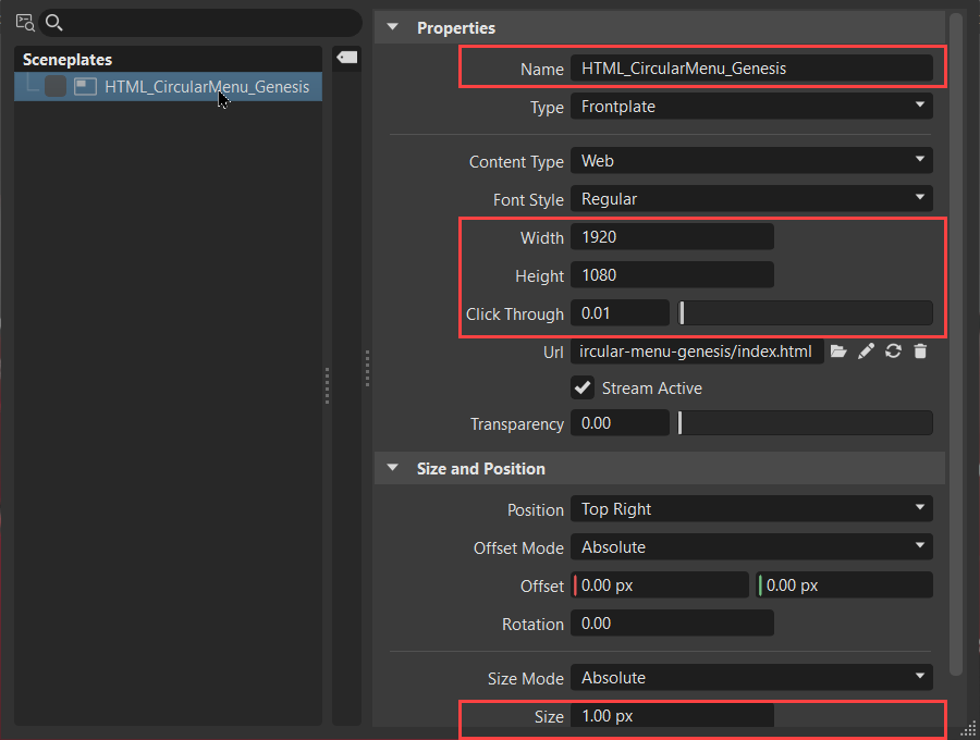

In the Menu Bar, select Scene > Sceneplate Editor.
Right-click in the left side of the Sceneplate Editor and select Create Frontplate.
Under Properties, in the Name field, enter a name for the frontplate and for Content Type, select whether it will be text, web, or an image.
- For a text frontplate, enter the text you want and properties, such as font, color, and transparency.
- For an image frontplate, click the folder icon and select the image you want; if at any point the image is updated, click
Restore to load the latest version.
Under Size and Position, adjust any necessary values.
For absolute scale, pixels are used. For relative scale, percentage is used.
