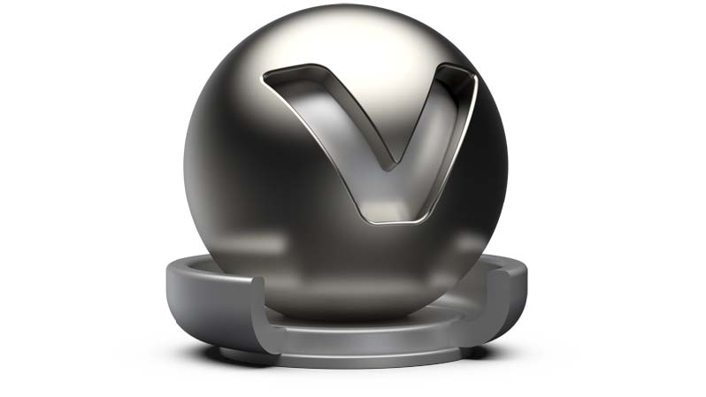

Brushed Metal
Brushed Metal
The brushed metal material type simulates any type of metal; it gives full control over the scale and orientation of the surface structure. Metal type presets are available within the Properties Editor.
For this material, there is no choice between UV and Planar Mapping. The texture mapping is as follows:
  • For Diffuse, Glossy, Bump, and Roughness, it depends on the brush mapping orientation.
  • UV-mapping is used for radial and planar brush mapping.
  • Triplanar mapping is used for triplanar brush mapping orientation.
  • UV-mapping is always used for Incandescence, Transparency, and Displacement textures.
