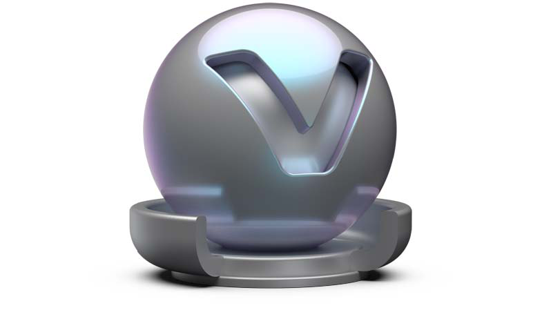

Flipflop car paint material provides two layers of flakes on top of the base coat color. Its appearance depends heavily on the viewing angle between surface and observer. The effect is seen with paint on show and model cars.

Video captions: Create a FlipFlop material and assign it to your geometries. In this case, let’s replace the given varnish select nodes and apply it to the selected nodes. We can find the same material settings as with the Metallic Carpaint material. In addition, there are two flake color settings and one blending controller; therefore, the varnish’s color is a blend of the base color and the flake color. The two flake colors depend on the angle of view. While using the Blending controller, you can set the power measure of the two flake colors. You can add some more detail to your orange metallic varnish by simply changing the values slightly.

Flipflop Carpaint Material Settings
  • Base Color - This attribute defines the basic color, the main characteristic of the material. Use the slider to change the brightness. Click the color field on the right to open the color chooser.
Flakes
Describes the metallic flake’s behavior, which is embedded in metallic paints. They have a strong specular light reflection and are layered on top of the base shading color.
  • Flake Color 1 - Defines the color of the metallic particles on top of the lacquer layer. It gets stronger and more brilliant the further the normal orientation points away from the camera.
  • Flake Color 2 - Defines the color of the metallic particles on the second layer of flakes. It gets stronger and more brilliant the further the normal orientation points towards the camera.
  • Blending - Defines the mixture ratio of two colors. Drag the slider to the left to increase the intensity of color one. Drag the slider to the right to increase the intensity of color two.
  • Roughness - Sets the roughness of the flake surfaces. A lower value represents a smoother surface resulting in more specular reflections, while a higher value represents a rough surface resulting in more diffuse reflections.
  • Flake Size - Sets the size of the metallic particles on top of the lacquer layer. The higher the value, the larger the flakes in the paint.
  • Flake Intensity - Sets the amount of variation in the flake´s normal directions.
