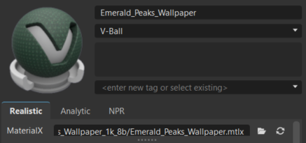

MaterialX
  1. Download MDL materials from the Nvidia website and MaterialX from the AMD website.
  2. In the Material Editor, select Create > Create Material, and select either a MaterialX or MDL material.
  3. Double-click a MaterialX or MDL to load the material definition into VRED. Now, you will see all available editable attributes.
